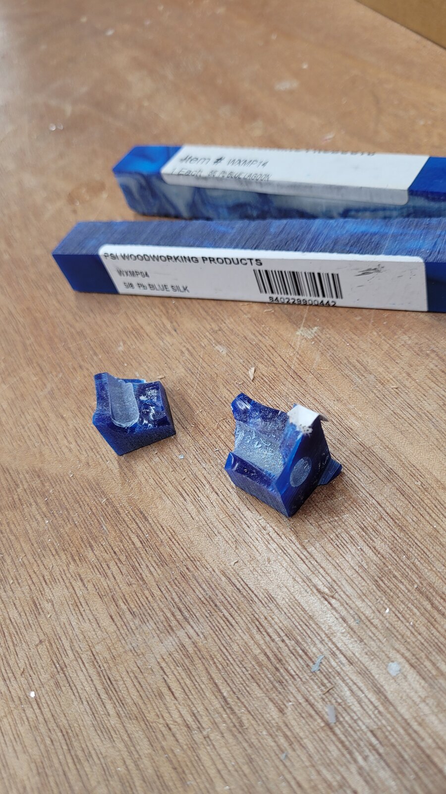

These are mica pearl blanks from psi. I had my first explosion today while drilling. I wound up setting the depth stop so I left 1/8th and then sized to length.
It really doesn't like being worked. They also chip out a ton while turning, but the chipout is pretty controlled, so you can manage.

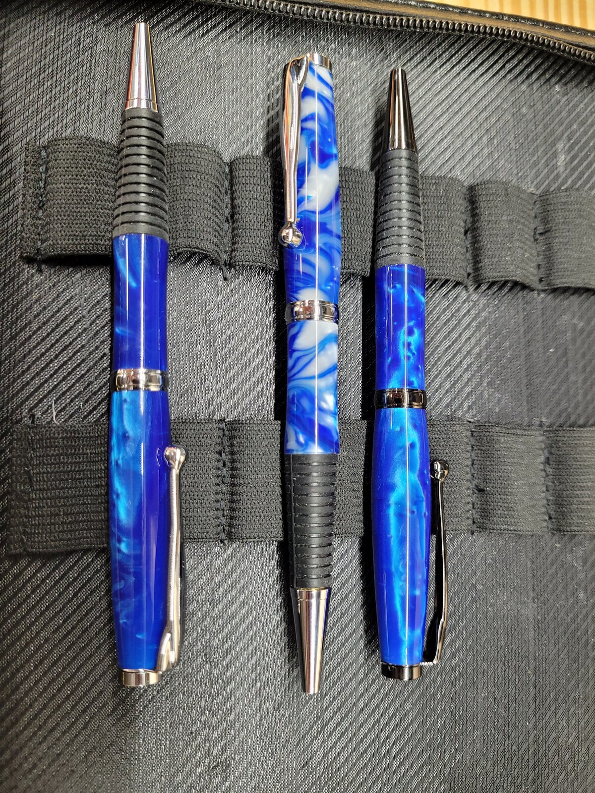

The results are pretty nice though
Brad point bits have cutting surfaces that are far to aggressive and grabby especially for plastic blanks and especially when breaking through on the bottom of the hole.
I use standard twist drills and drill slowly in a kind of pecking motion to clear the flutes of the bit very frequently and to help reduce heat buildup - heat is one of the real culprits when it comes to blowouts on blanks. On some especially brittle plastics like Inlace Acrylester and on some hard and brittle woods like Ebony, I leave the blank long, mark the drill, and avoid drilling through, then I cut the blank off to expose the hole. (The drill pecking rule of thumb is to not exceed 3 times the drill diameter before withdrawing the bit on each peck).
At some point, I wound up buying a few drill bits that are made specifically for drilling plastics. Instead of the typical 118 & 135-degree point drills, the bits made specifically for plastics are ground to a steeper, 60-degree point angles. This allows for more gradual penetration and significantly less friction (heating) when drilling. They are also less aggressive (grabby) in how they cut. Although it is probably overkill I have for the most part acquired a considerable set of these special 60-degree drill bits in the common pen tube sizes.
Regardless of the equipment and drill bits you use, remember, heat buildup from friction during drilling (packed flutes, etc.) is the primary cause of problems. Drill slow, use sharp bits, use the pecking method, etc. and I'm sure you will get satisfactory results.

PS The pens are gorgeous!
Drilling is certainly my least favorite and least successful part of pen making. The advice every gives here is top notch and I appreciate it.
It looks like my dp was set to 800rpm. I slowed that down to 390.
I was clearing chips every 1/8-1/4" and I was using some paraffin on the bit to reduce friction.

I would give serious consideration to drilling on your lathe. You would need pen jaws for your headstock, and a drill chuck for your tail stock, but the accuracy of drilling (the headstock and tailstock are already in alignment), and the ease of advancing and retracting the drill bit is, in my opinion, far superior to using a drill press with a vice holding the blank. I did that for a couple years, with more than occasional blowouts through the sides. Getting perfect alignment of the blank and drill bit on a drill press is not as reliable as on the lathe. Since I have been using my lathe for drilling, I have not had a single blowout.

What RPM are you drilling at? And what type of drill bit? Brad point drill bits are notorious for causing blowouts.
I actually disagree with this. :p I find that with certain materials, bradpoints, because they cut at the edge, actually can give you a much cleaner exit hole. I have had more blowouts in brittle materials with normal bits myself.

As you can see from the replies above , there are several different ways to skin the cat . I`ve used brad points (not always sharp) on the drill press almost exclusively since I started this game . You like them because it is easier to find the blank center . I like them because it is easier to drill off center when my read of the blank tells me that I will get a more attractive pen that way .
Drilling in 1/4 inch pecks to keep the flutes from clogging , leaving the blank long by the an amount equal to the drill point , stopping drilling as the point just starts to come through , then cutting or grinding the excess away , works on all materials .
As others have said , frictional heat buidup is the principal enemy . On low melting point plastics and hard dense woods , I add lubricant to my regime , specifically water . Messy , yes , but the most effective coolant . Oil as a lubricant has some potential for adhesion problems . As a general rule , if the bit is too hot to hold your hand on after a peck , trouble is lurking .
