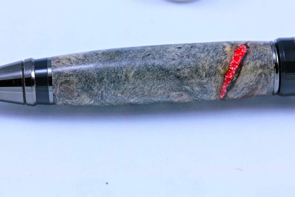

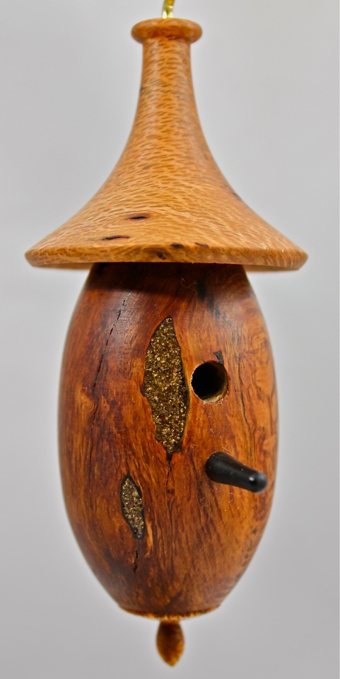

I have not used the metal dust, but have used their crushed coral inlay, as well as embossing powder.
I simply placed a few drops of medium CA in, poured the powder through a small funnel (anything will work) with a tray under to save what dropped off.
Applied accelerant, made 1-2 more layers to be slightly proud, then turned, sanded, finished as usual.
Good Luck.
