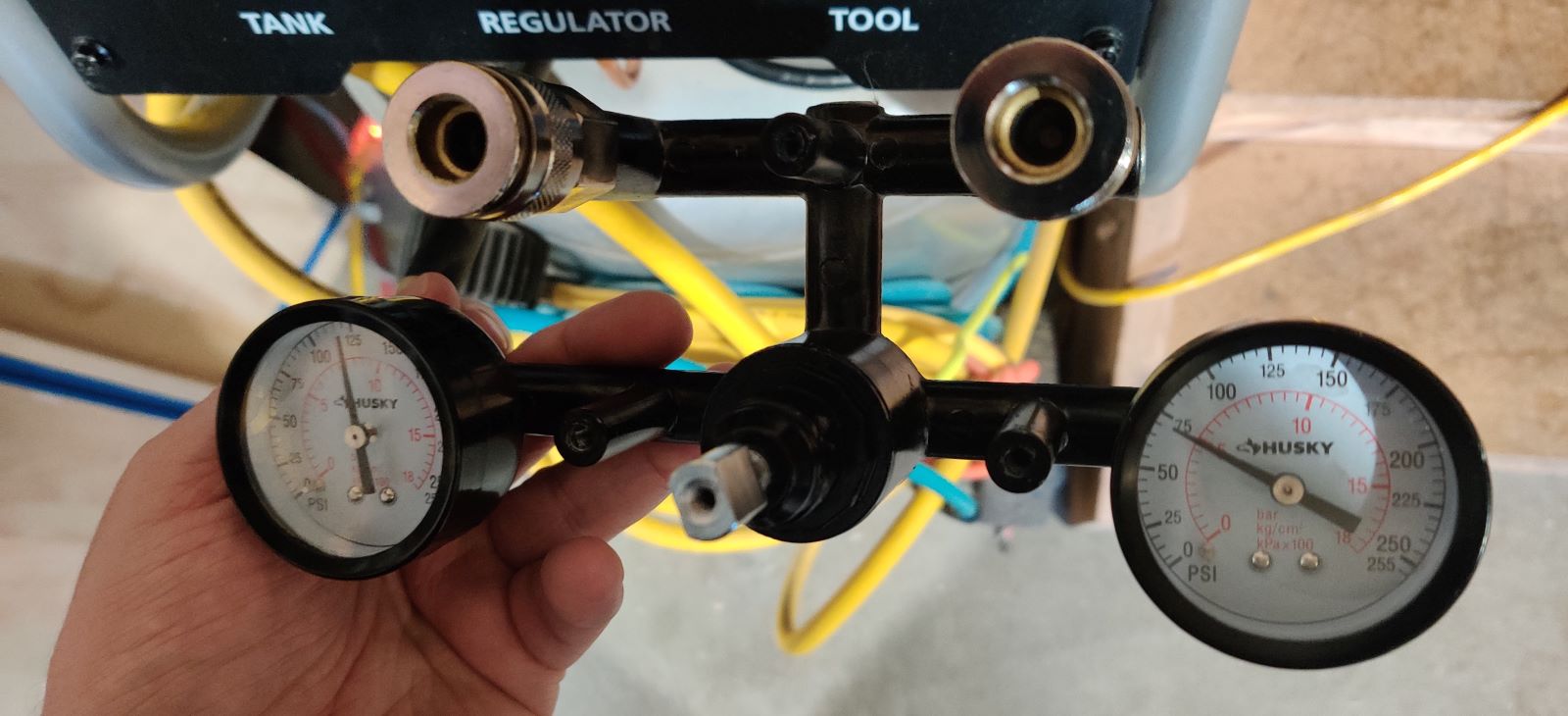

Here is the whole manifold, with the regulator (sans knob) in the center.
The regulator screwed into place:

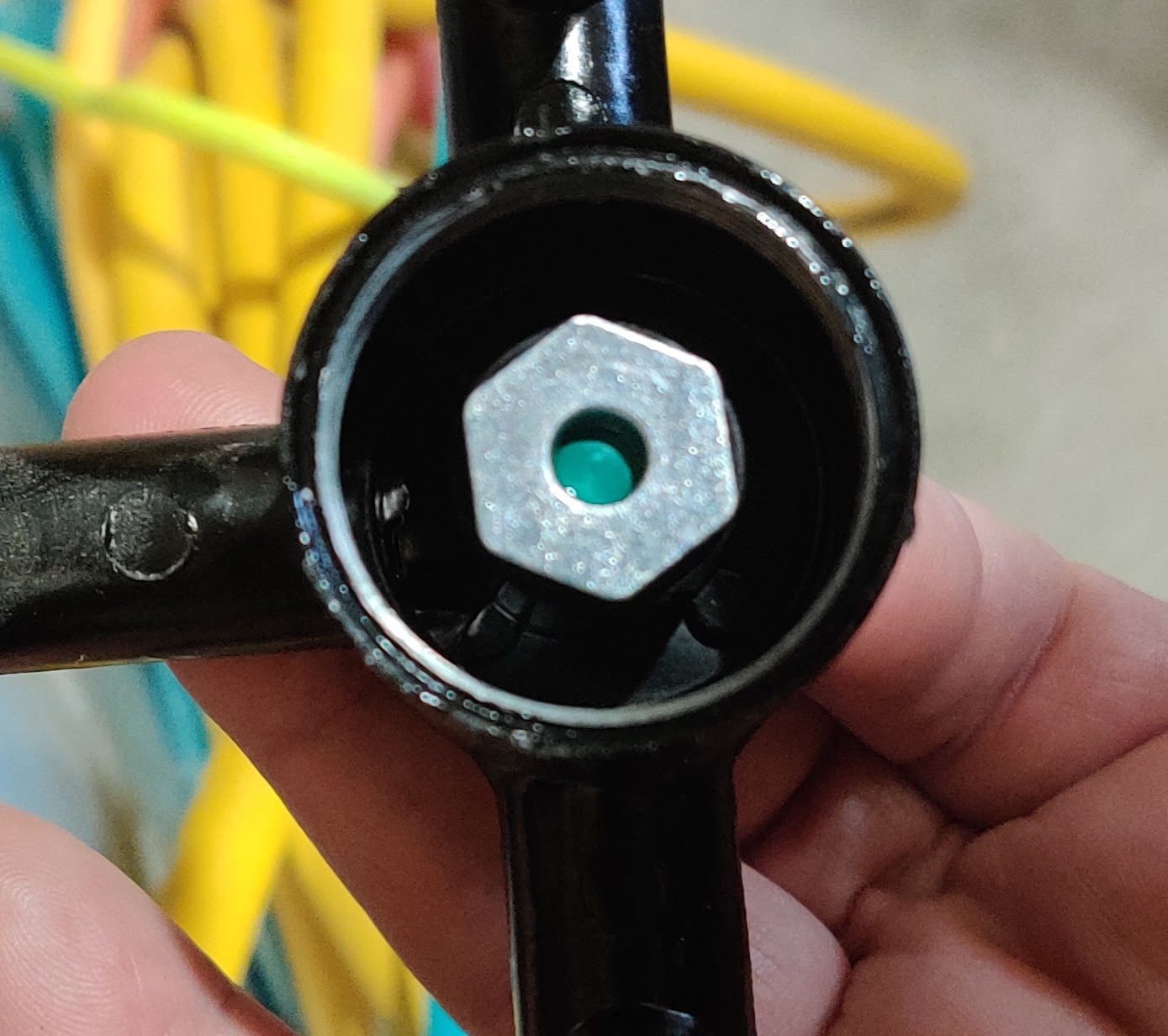

In the manifold is the "membrane" as I've called it. Pressure from the tank (inflow side) is held behind this, and the regulator's nozzle pushes it inward to allow airflow:

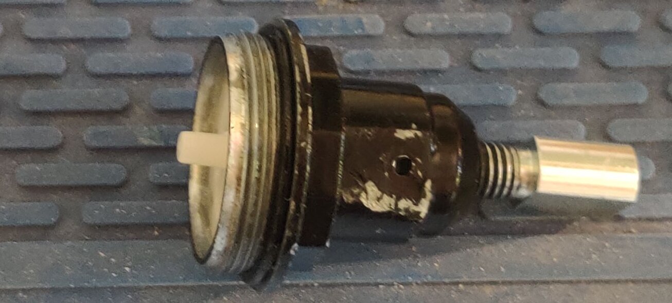

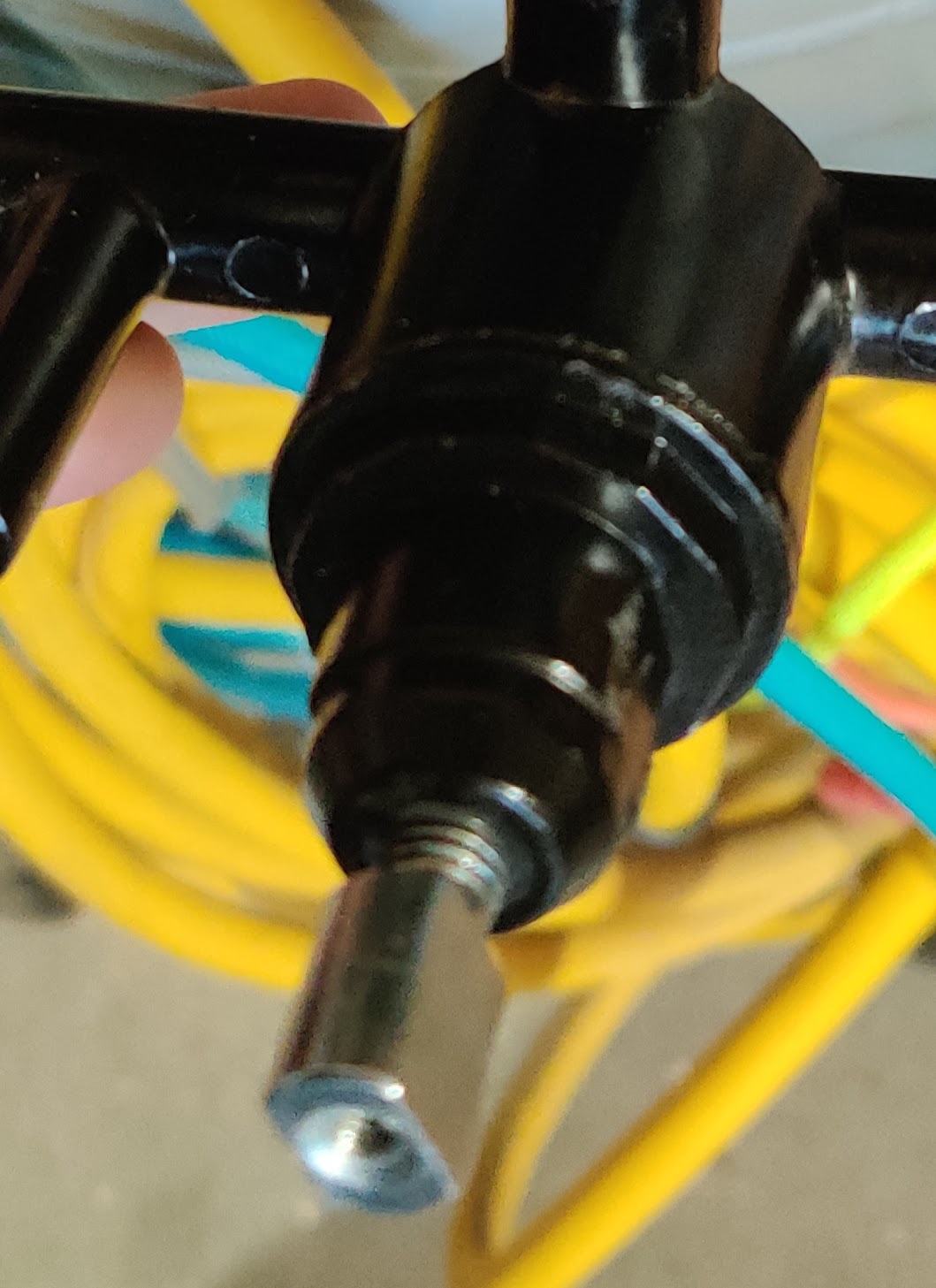

The regulator assembly removed. There is a small hole on one side that you can see here, which is where excess pressure from the outflow side is released when you back off, or reduce, the regulated pressure to the lines:

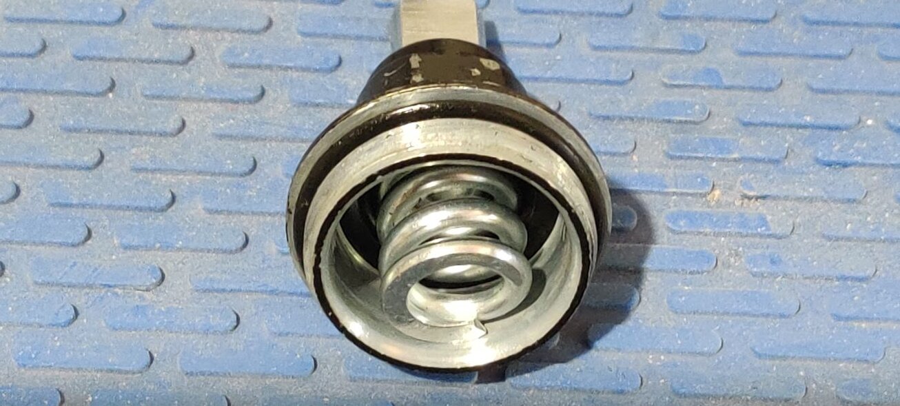

The housing with the spring that maintains (or at least, is supposed to maintain, maybe this is the problem) a reverse pressure on the nozzle part:

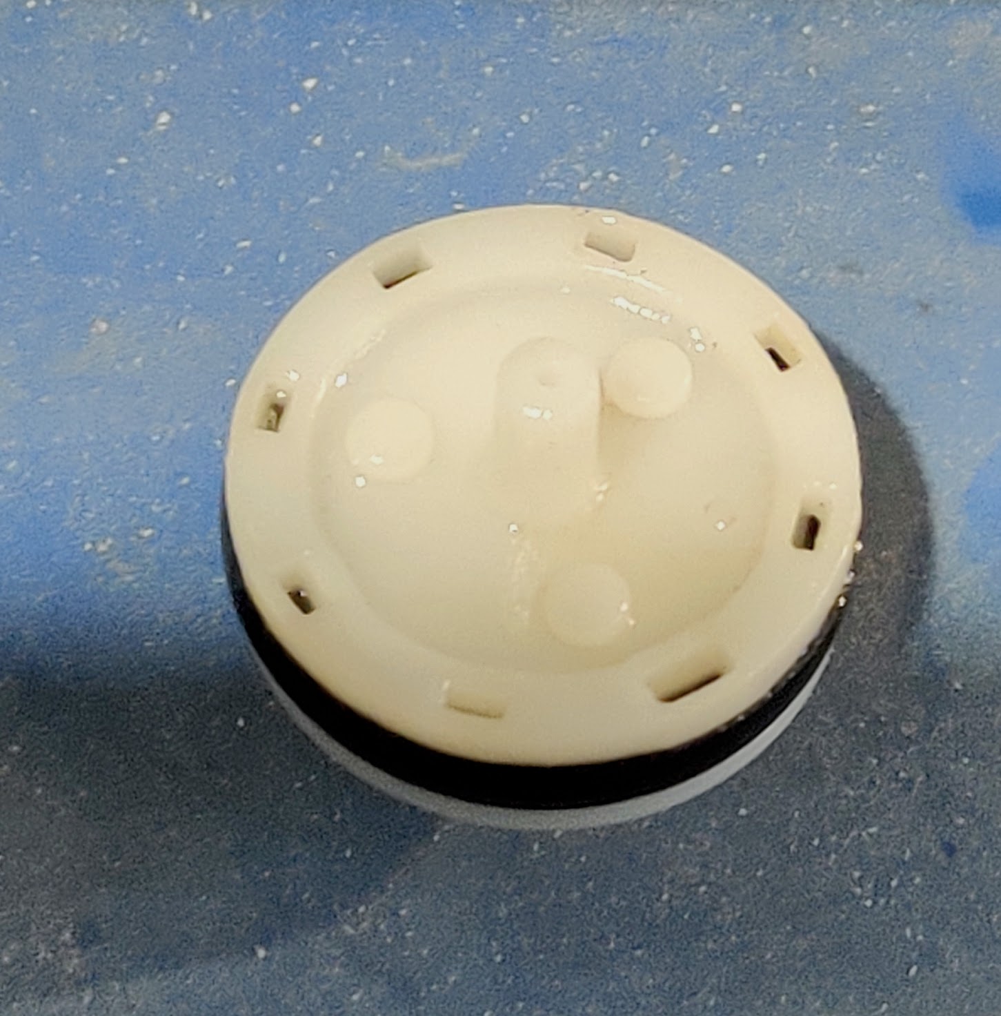

The nozzle part. There are several rectangular notches that allow pressure within the regulator assembly and outflow area to fill a groove in the o-ring here. So as the regulated pressure is increased, the pressure pushing the o-ring into the inner wall of the regulator assembly housing ALSO increases. I have not noted any leakage through the o-ring here...the o-ring seems to work fine, and the pressure-dependent nature of it seems to work fine (so long as the groove in the o-ring is facing the right direction, which should be to wards the manifold.) This is the part that has a nozzle that presses up against the "membrane" in the manifold assembly, with a hole in the center that I believe is where excess outflow pressure backflows when you reduce pressure:

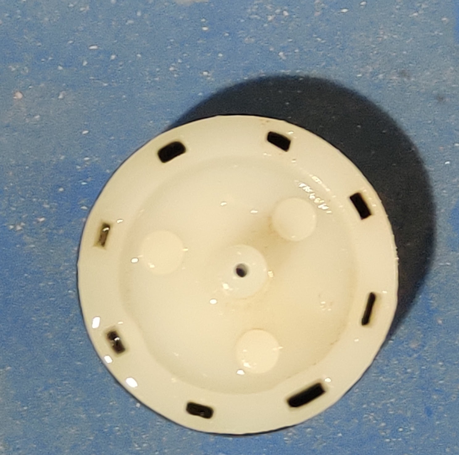

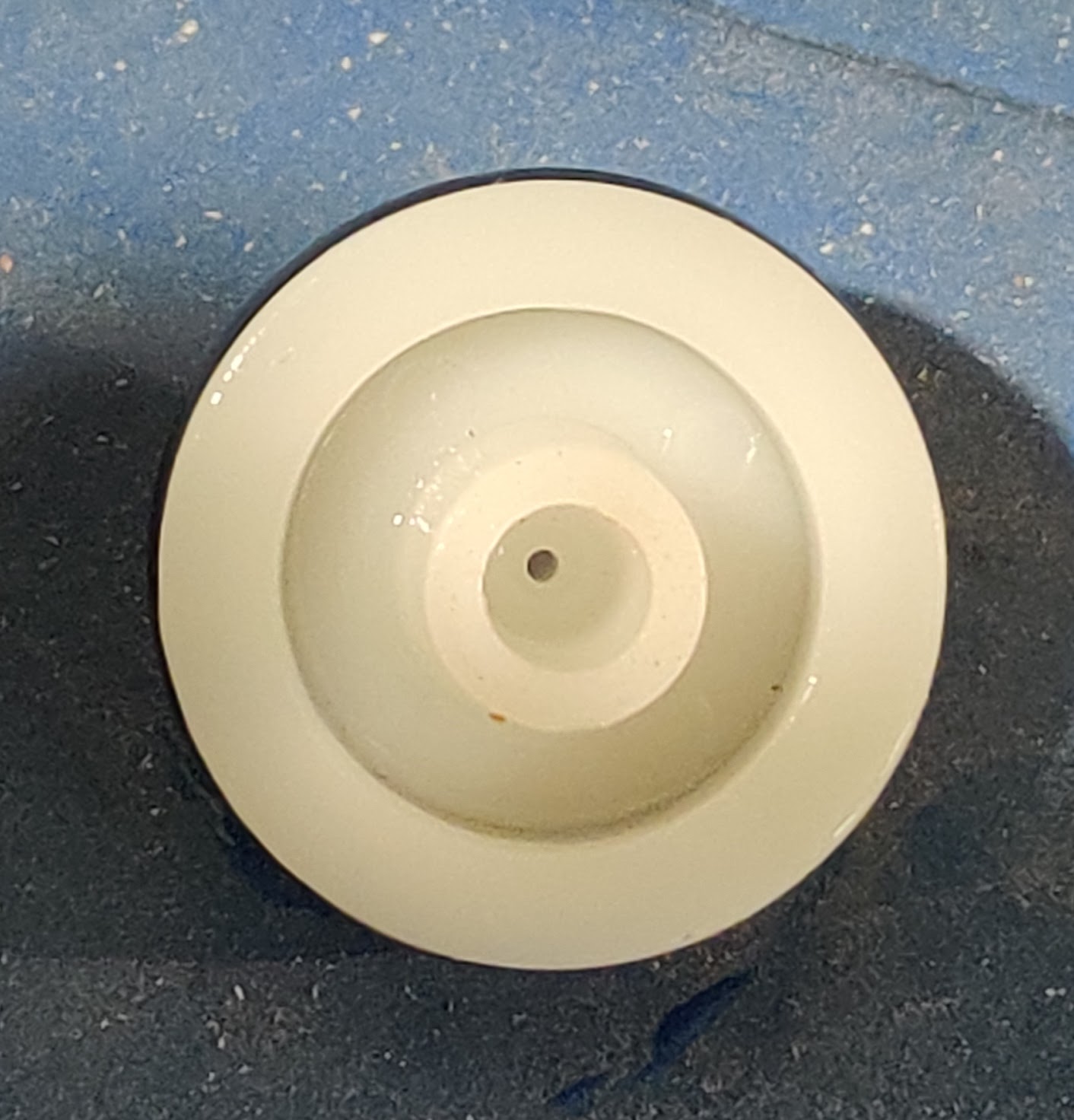

Sorry for the potato quality, was having trouble holding my phone here (I think I had it on macro zoom, which exaggerated any motion). A top-down view of the hole in the nozzle that presses up against the membrane to release pressure from the tank, into the outflow (which connects to up to two different hoses). The hole is by design, IMO, as its where excess pressure from the outflow area is released when the regulated pressure is reduced:
A view of the back side of the same part above. The larger circular part in the middle, fits perfectly inside of the spring that resides in the regulator housing:
Air flowing through the hole here, then escapes the hole in the side of the regulator housing as shown in an earlier photo. I've simply arrived at the function of how this regulates pressure by examining all the various parts, as I've spent a good while now trying to figure out WHERE the hiss was coming from, and how and why the air was escaping. I'm pretty sure its the front of the nozzle where it contacts that membrane. I think air is escaping from that...interface, of plastic to rubber. It seems to happen regardless of pressure (unless the pressure is around say 25psi or less)...but, at higher pressures (say 100psi) then the problem is certainly worse, the hiss is definitely louder.
