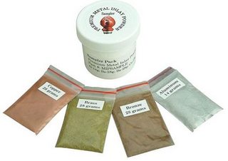

Has anyone tried using metal inlay powder to accent the engraving on a blank?
Grizzly (of all people) and Amazon have listings for it.
Rub n buf comes in a tube at Hobby Lobby and other craft stores.
