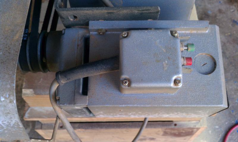

The motor on this particular systems does not direct drive the belts. There is a geared reduction system between the output of the motor and the pulley. You can see this in the picture. It is the thin box between the motor and the pulley. This a common complaint about this unit. Even with 28db ear plugs I don't intend on running this for very long until i get a new motor.
I turn the system by hand without the belts and the systems runs smooth. Without the blade, the wheels have no slop. The guide bearings on the conversion kit are shot and I have ordered some new ones.

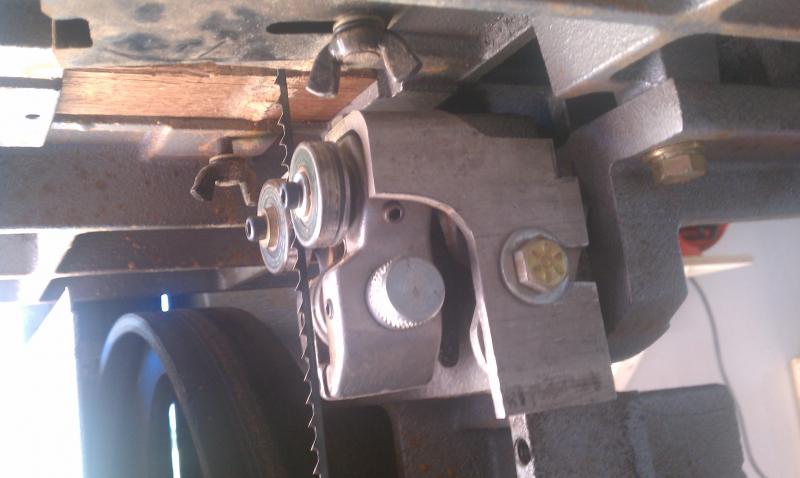

I have one of the Makita saws and have the bearing guide parts from Carter to put on it. I wouldn't mind seeing a few pictures of the guides you have.
The saw is indeed a screamer :eek: and was due to the need to slow down the rpm of the universal motor. Basically it is a 3 HP router motor spinning in the 24000 rpm range and the spur reduction gears add to the noise. When mine went I happily replaced it with a 1 1/2 HP 110V induction motor. Marathon I think. That made a huge difference it the noise. :) The saw was designed for Japanese timber framing type work so was intended for cutting softwoods, sometimes on the job site. Makita's blades certainly didn't like dry hardwood like Eastern Maple.

I have not done much digging into the guides to figure out if they are still available but I did find Carter's website and they still sell lots of upgrade units. The upper unit is a Carter CP-20. It has one bearing wheel then 2 adjustable metal guides on each side of the blade. Sparks a little when you run it. Will have to figure out if this is normal. The lower unit is a Carter CP-500. This one has 3 bearings. A you can see from the pictures, they had to fabricate mounts. All the bearings are 10mmx30mmx9mm. I order a replacement box of 10 bearings for 9.95.
There is only one original lower guide left and none of the blades. So my resaw capabilities are now tied to what blade i can get to fit the new setup. Which is not a problem as I was needing a band saw to make inlays and segments.

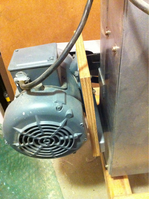

I would like to see a picture of how you put a new motor on your saw. I am planning a new base for this one and plan to have a enought room behind the unit for new motor to mount to the base instead of on the side.

I put the motor on the side using the existing mount and a piece of plywood. Metal would likely be better but I only had woodworking stuff at the time. Under would be better to reduce the footprint and lower the centre of gravity.
