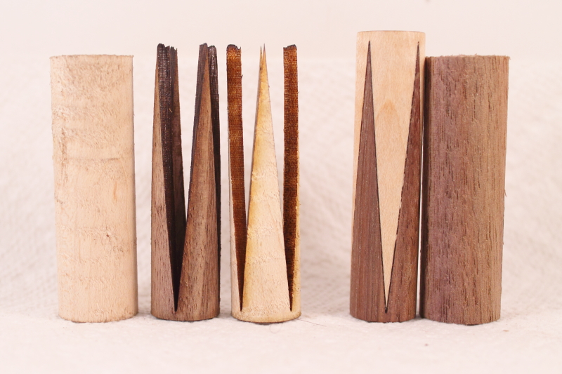

So ... I got a custom order for a pool cue blank for a Mistral RB. The woods for the order are African Blackwood and Curly Maple. Before I potentially waste premium wood I always like to make test blanks out of non-premium wood (maple and walnut in this case). There are several methods people use to make a pool cue style blank and this is the method I use. Once the maple and walnut zigzag pattern is cut on both blanks, the two halves are taken apart, the colors mixed and the two halves slid back together

Cool method. Do you cut them with a scrollsaw? Does the resulting hollow match the diameter of the tube?
I cut them with laser that uses a custom built for pen blank rotary. The source blanks are prepped by drilling them to brass diameter and then rounded between center to 1/8" wall thickness on metal lathe using bushings that are sized to the drilled holes.

Cliff, did it involve using a router and and 90 degree bit. I've seen video were some cue manufacturers do it that way. After the corner is cut another piece of wood's corner is glued into the groove and then the cue is rounded back down afterword. Hope, I'm making a little bit of sense here. As far as ease and laser cutting ... after the hollow tubes are created it only takes about 1 1/2 minutes to cut the zigzags. You pop the 2 halves apart and press them into the 2 halves of the other blanks put about 4 rubber bands around them and flood the seams with CA and you're done. I could make them all day.

2. As far as ease and laser cutting ... after the hollow tubes are created it only takes about 1 1/2 minutes to cut the zigzags. You pop the 2 halves apart and press them into the 2 halves of the other blanks put about 4 rubber bands around them and flood the seams with CA and you're done. I could make them all day.

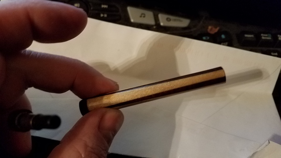

1. no but I did use a jig that I have that squares the blank to the tube. I made a core of walnut and then wrapped the other wood around it. I think I used this article for a start.
Turning a Pool Cue - FineWoodworking
2. well that's just plain cheating. :wink:

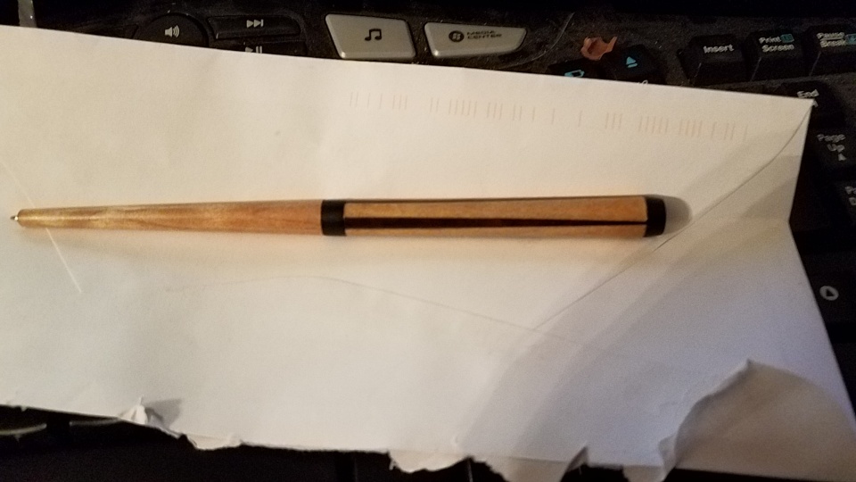

found it it was right in front of me on my desk.
I wish I could have added more bling to it but it was for the modified slimline contest from a few year back and had a time crunch.
If I could have taken the band end down more it would have got pointier.

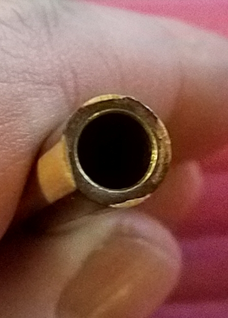

I tried the corner thing and think it turned away. The pen guts got in the way.
