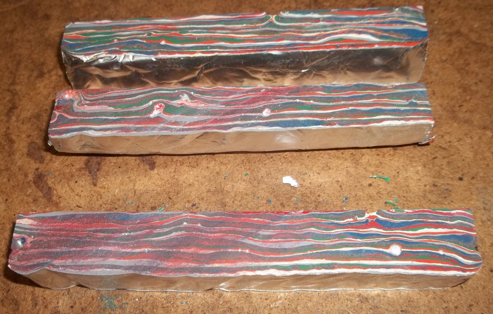

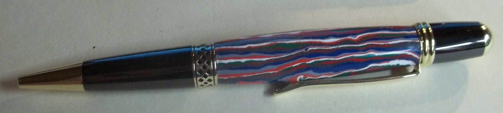

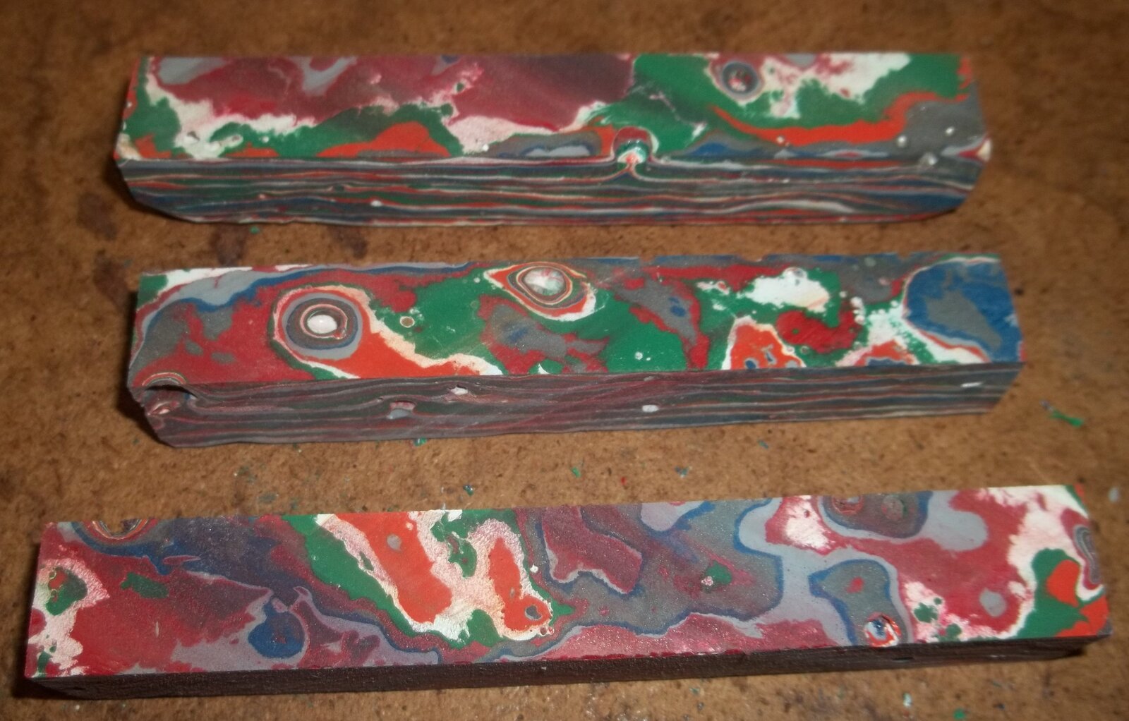

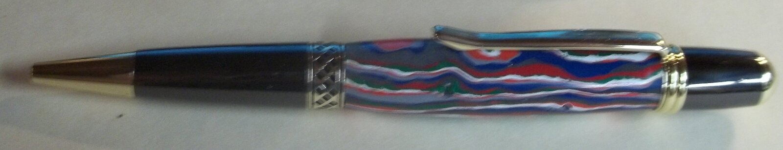

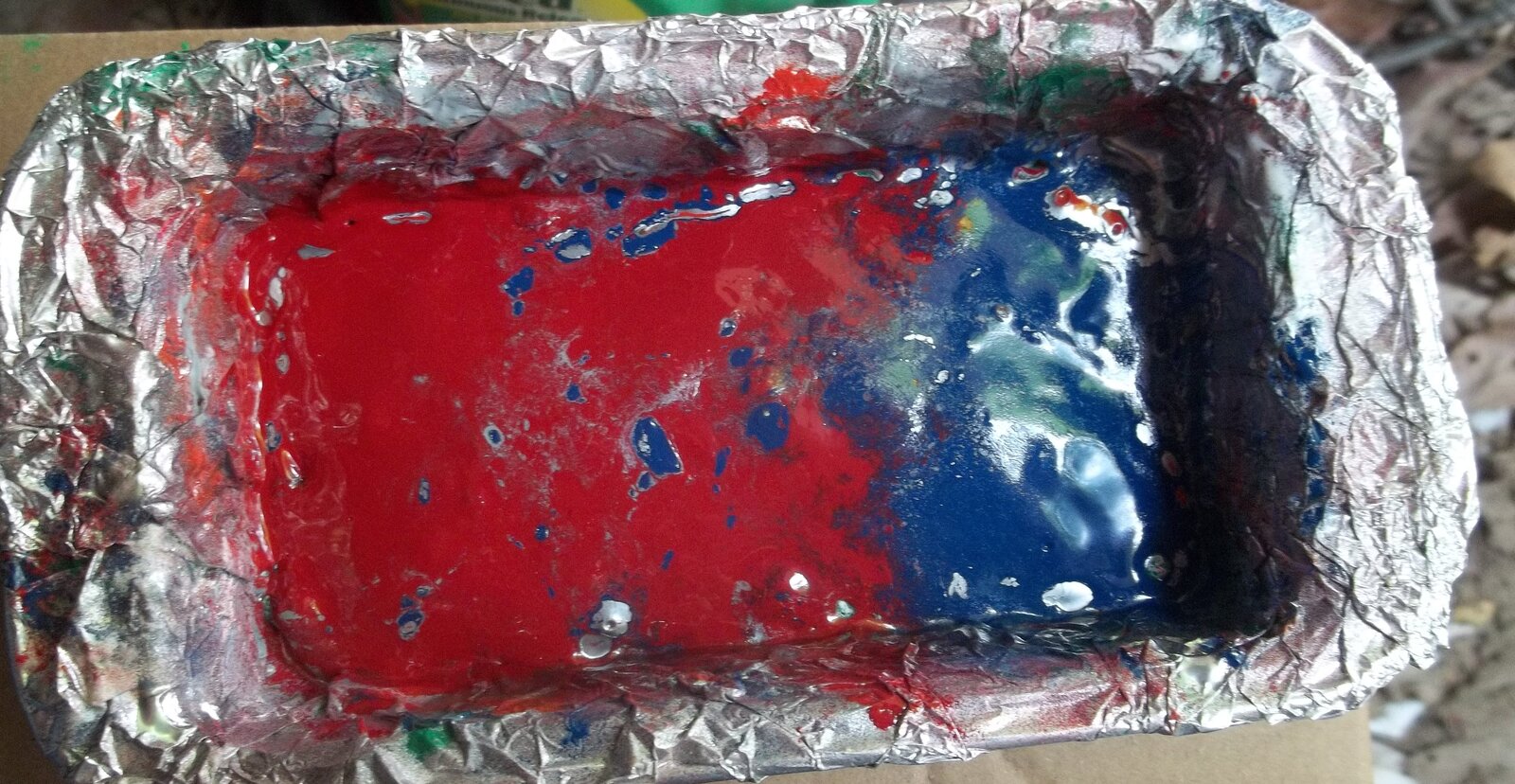

Here are the results of my 2nd attempt at making fordite. I placed the mold in the oven and flowed out the powder after every 7 layers. I used 56 layers to produce the block. This took 4 to 5 hours and 11 ounces of powder to complete. There are still some bubbles but they should be able to be filled with CA during turning.
I will make another attempt using a lab hot plate to continuously flow out the powder.
