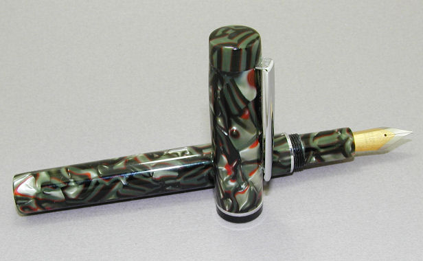

I've done a few. I'm attaching a pic of one of them. I'm just using a wood lathe, so I turn down a kit section, then cover it with the blank material. It's a cheat, I supposed, but I think the results are ok.
