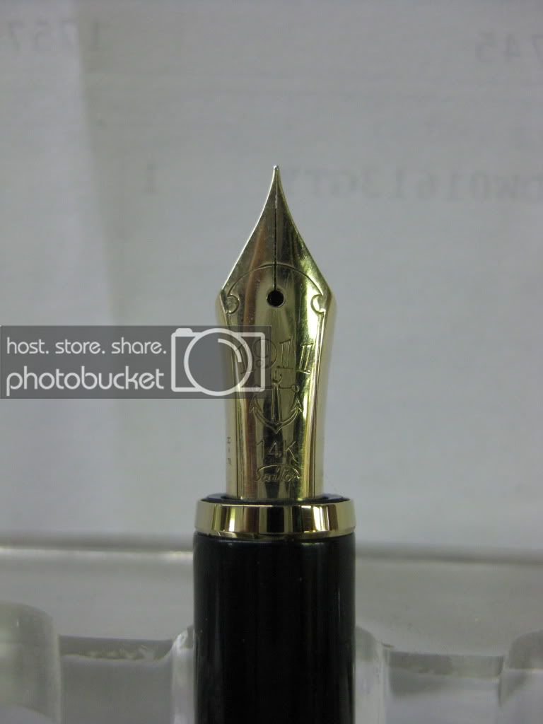

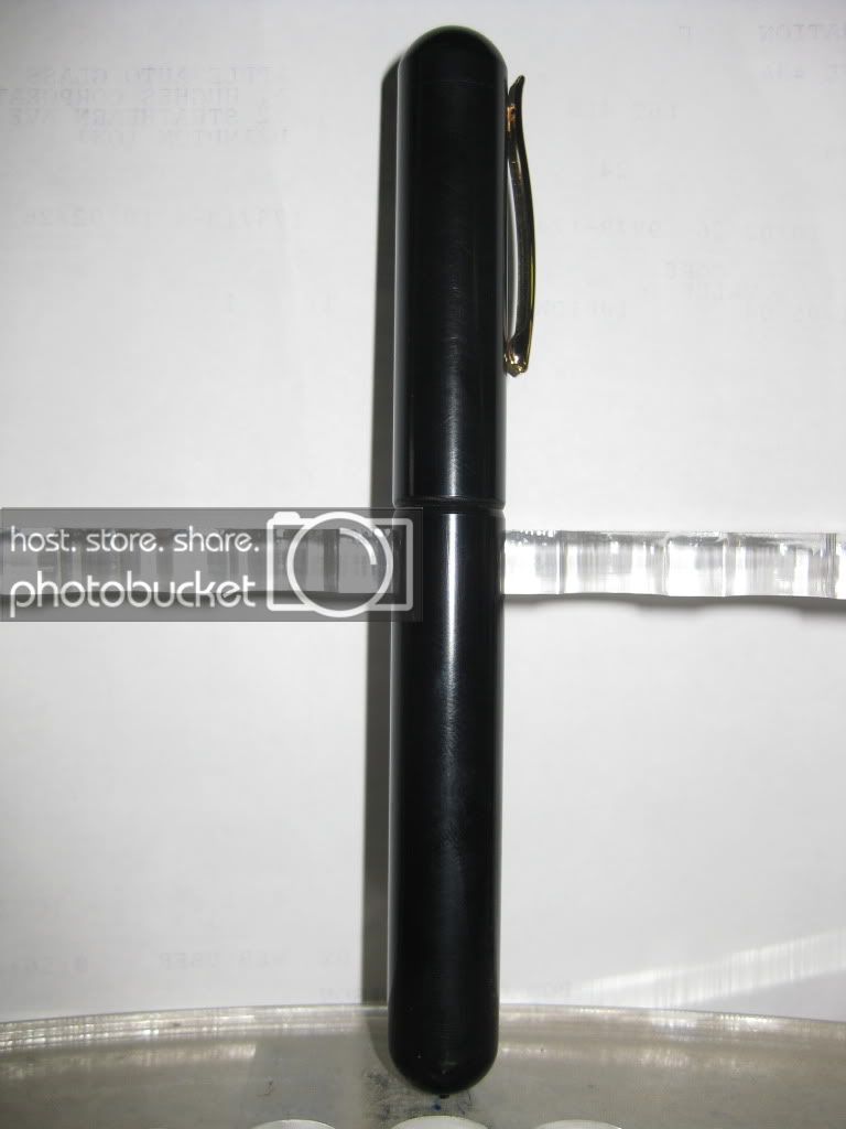

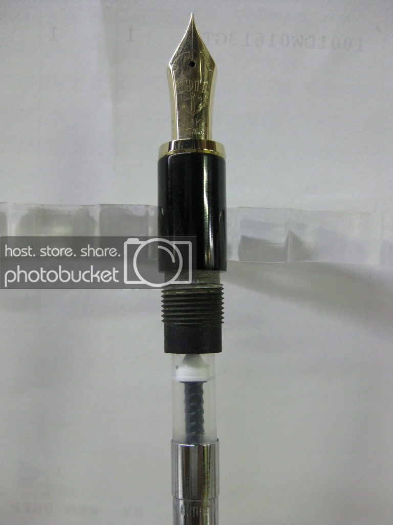

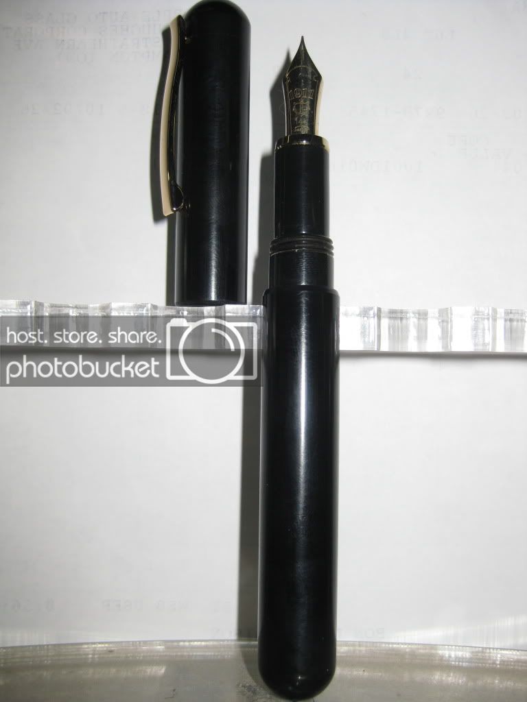

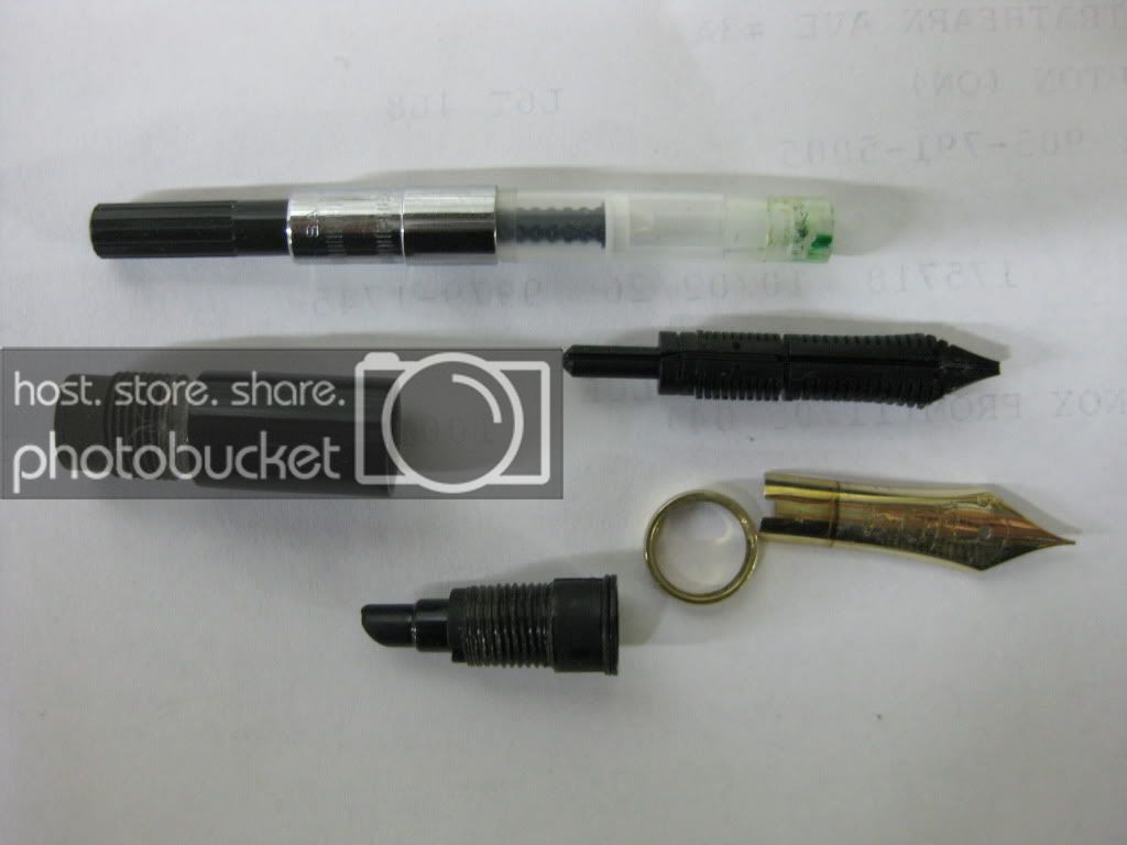

I got this Sailor section in a while ago. The grip was a plastic so as I am making a ebonite body for it I thought I could also make a ebonite section. I used the nib unit and saved the little gold trim ring. The pen will have a matching gold clip on it as well.
I have not got the final go ahead on the final size and shape of the body but when I get it done I will post it as well.
