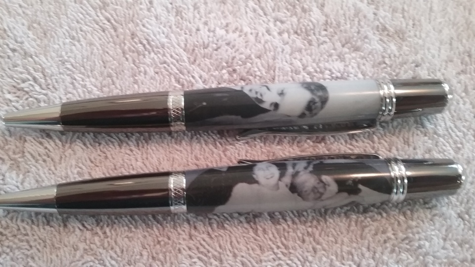

What is the best way to glue a photo to the brass tube? I have never tried to make a blank but want to get my feet wet. Use C/A glue or other type of adhesive? I would think C/A would be difficult for a beginner.
I've taken photos and copied them with an inkjet printer. That way I could size them to the size I wanted. Then I paint the tube white and glue the picture on with Elmers.

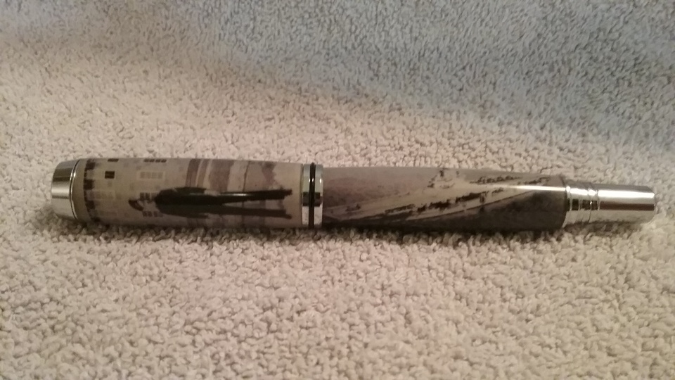

These I did with Avery Tru Block shipping labels and epoxy resin.
