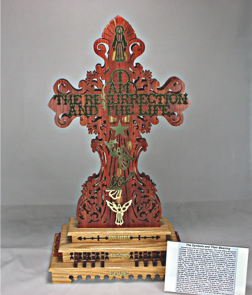

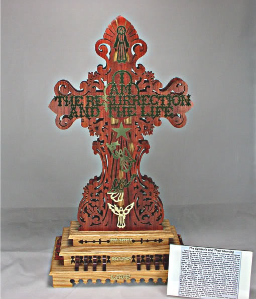

Red heart is a nice red wood and I have had success with it staying more reddish than turning dark browns. Yes top coating will help. But this projects only has a Danish oil on it. Still as red as the day I made it. I try to keep out of sunlight from windows.
