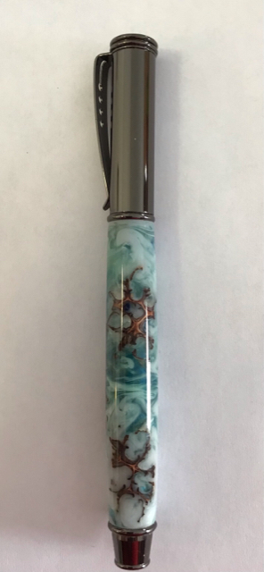

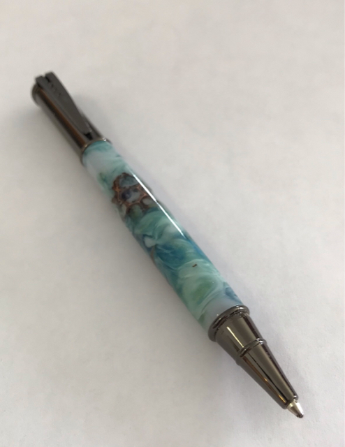

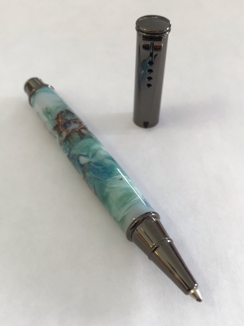

First time making this kit. First time trying out TBC and made from one of the blanks i got in the recent BASH pith. Kit is the Editor from Exotic Blanks. The blank was made by Cody Walker. I seen these and thought with the smaller size, ladies would like them to keep in their purses. The kits are very inexpensive. They use a Parker refill and are postable. The cap snaps on very well. My wife claimed it as her own as soon as she seen it. The TBC method worked fine, but honestly, I didn't see any advantage. I just wanted to see what the hypes all about. To each his own [emoji846]

By the way, this Editor kit is one of those kits that you don't even have to get close to the bushing size. There is a little lip, part of the design, that extends quite a bit out from the blank. This kit would be an excellent beginner kit.

Nice pen Ken.
I do see that the hardware lends itself to some variance in the turned diameters which is nice. You are certainly correct in saying this would be a good kit for those starting out and much more forgiving compared to the slimline kit a lot of folks start with.
That blank is pretty cool as well.
