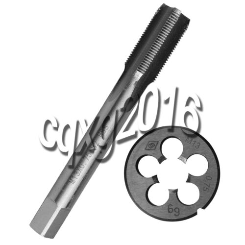

Amazon has a m13x.75 tap & die set for $20.
Thanks. I think it's diameter is bigger than my holder which is 1" Maybe the solution is to find a bigger holder. I have not graduated yet to being able to make my own yet.
It doesn't give the diameter but it would be more than 1". that size die would be anywhere you get one (i think the diameters are standardized)
