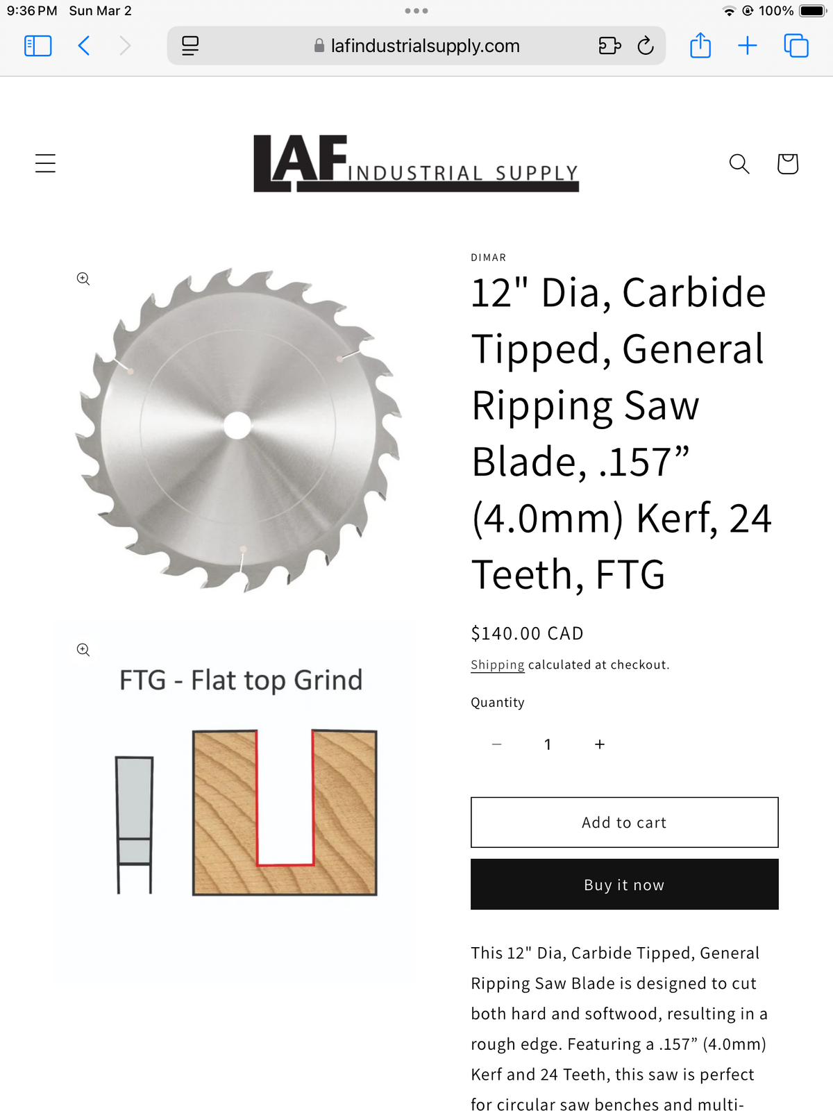

Try searching for 4 mm. I found this but it's 12 inches and no idea what the arbor hole is. They have a note to contact them if you can't find the size you're looking for.
