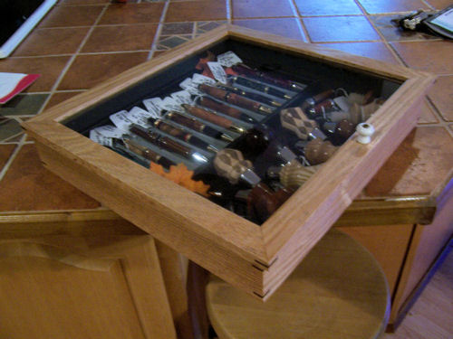

This is a display box with a hinged frame and glass. One could make one to hang on the wall using pen trays to hold the pens. Make the box to fit the trays. This one sits on top of a counter in the store.

The example you showed could be easily modified for a wall display. I think it could be done with out to many problems.
I'd do something similar to that. Just a frame and a back and a door. inside drill holes and use adjustable pins to hold glass shelves. Place acrylic displays on the glass shelves. The shelves could also be mirrors, or you could put a mirror behind the pens..but I think that's too busy. Light colored woods work best for pen displays in my opinion.

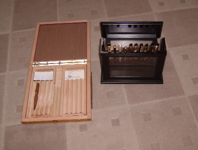

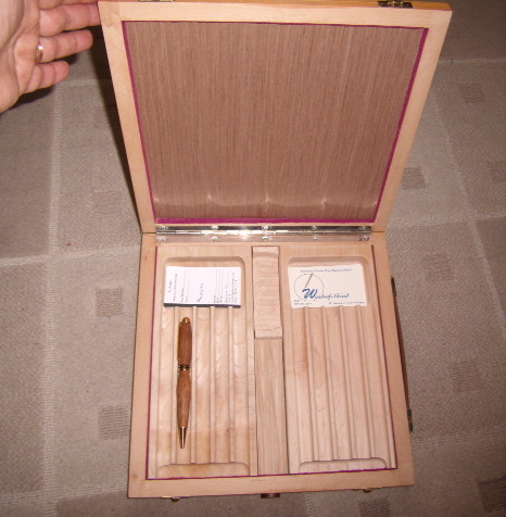

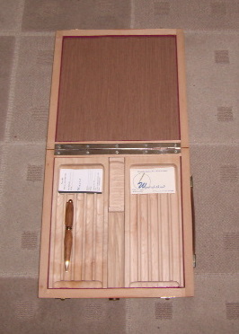

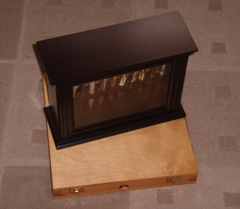

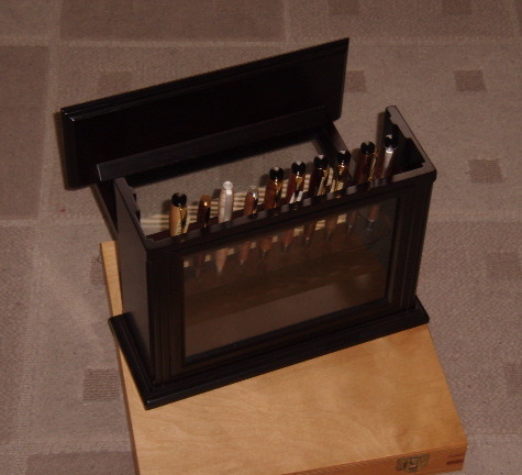

Display ideas
Hi Chris,
my apology for not posting sooner but here's a few ideas for displaying pens. One is a fully closed case that is best suited for getting the pens "safely" to your potential customer. By reversing the hinges, you can "flip" the top and thereby display like a photo frame. The second unit is probably better suited in that the pens "rise" when the top is pushed back (elevator idea). Close the lid and "down" they go. Although you can't mount the second unit on the wall, you can put the case on a shelf and thereby have the ability to clearly display. I've got a ton of pen cases that I've designed to hold my collections and will gladly provide more ideas if required.
