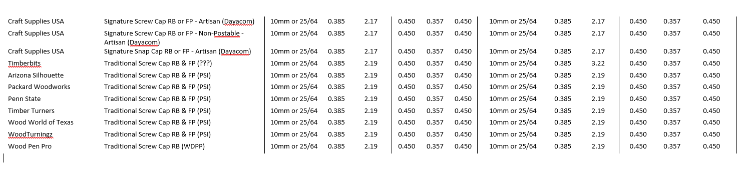

I don't have a set, but if you are about to put in an order with someone it looks like it uses the same bushings as PSI's Traditional.
I looked at the instructions for the pen and the two end bushings are .358 in. and the center bushing is also .358 in. Where did you find the chart you showed.... Conceivably I could order three sets of the penn state bushings and use the center pieces as ends as well.

The IAP bushings and tubes charts - https://www.penturners.org/resource...liers-bushings-and-tubes-new-july-2-2023.418/
What is listed above is :
Cap : drill bit, tube diameter, tube length, bushing outer diameter / inner diameter / outer diameter
and the same pattern for the body
edit - with the measurements you are reporting, I may be showing the wrong kit. I just did a search for "craft" "artisan" and then did a search for everything that matched with the bushing size shown first.
If you have calipers that would be useful to get the measurements off the kit itself.

Thanks a lot for pointing out the chart. As it turns out the bushings are the same for the artisan rollerball and the artisan signature.... I misread the diameters in my previous post. All of the bushings are .450 in. I'm good to go.
