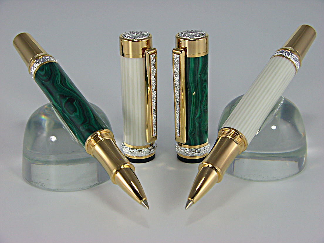

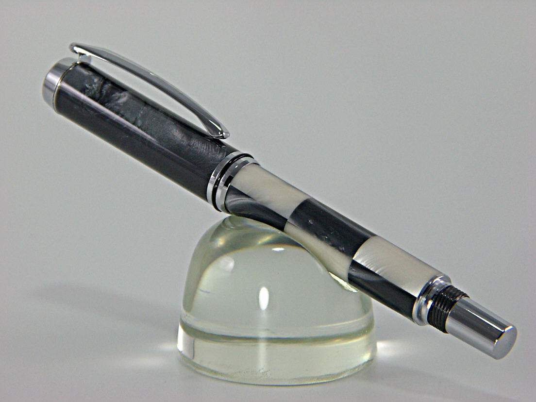

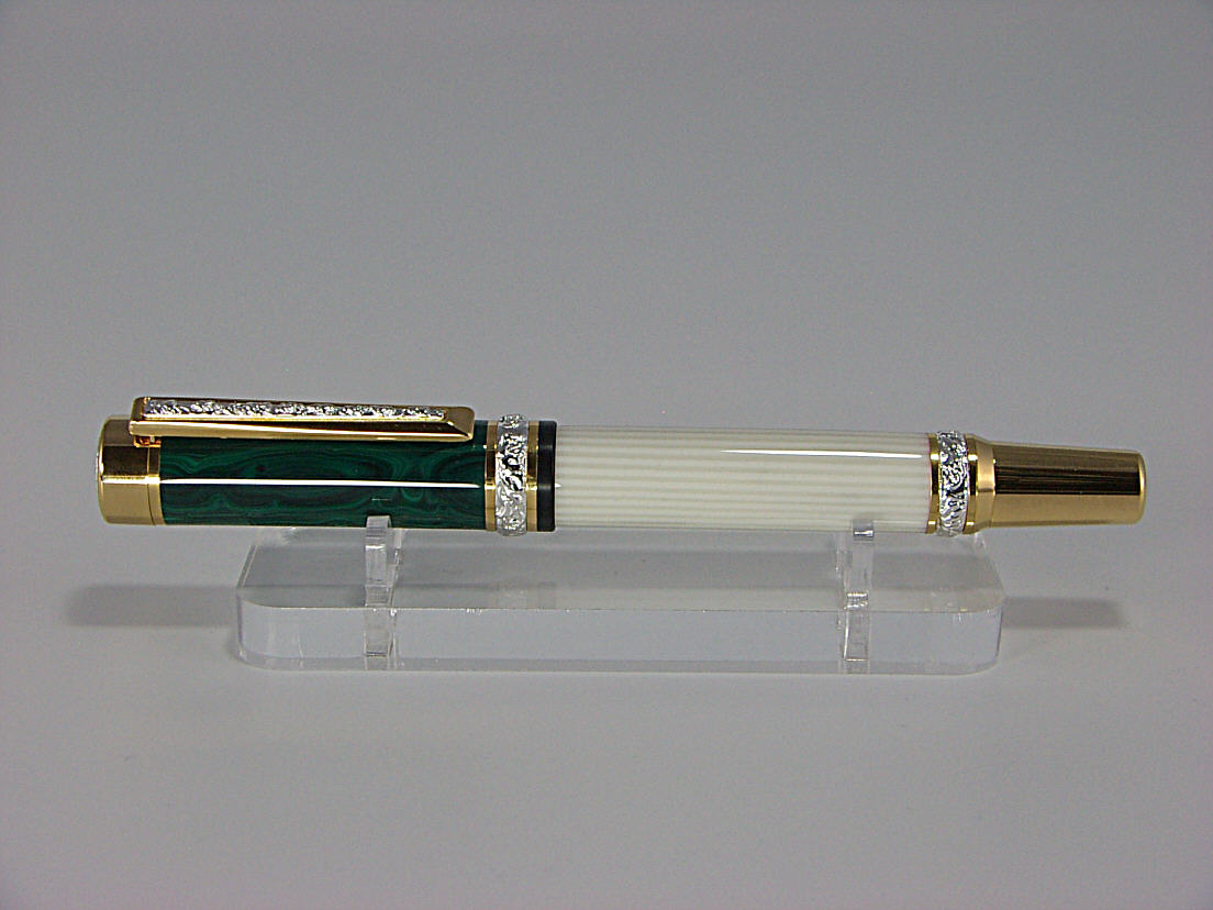

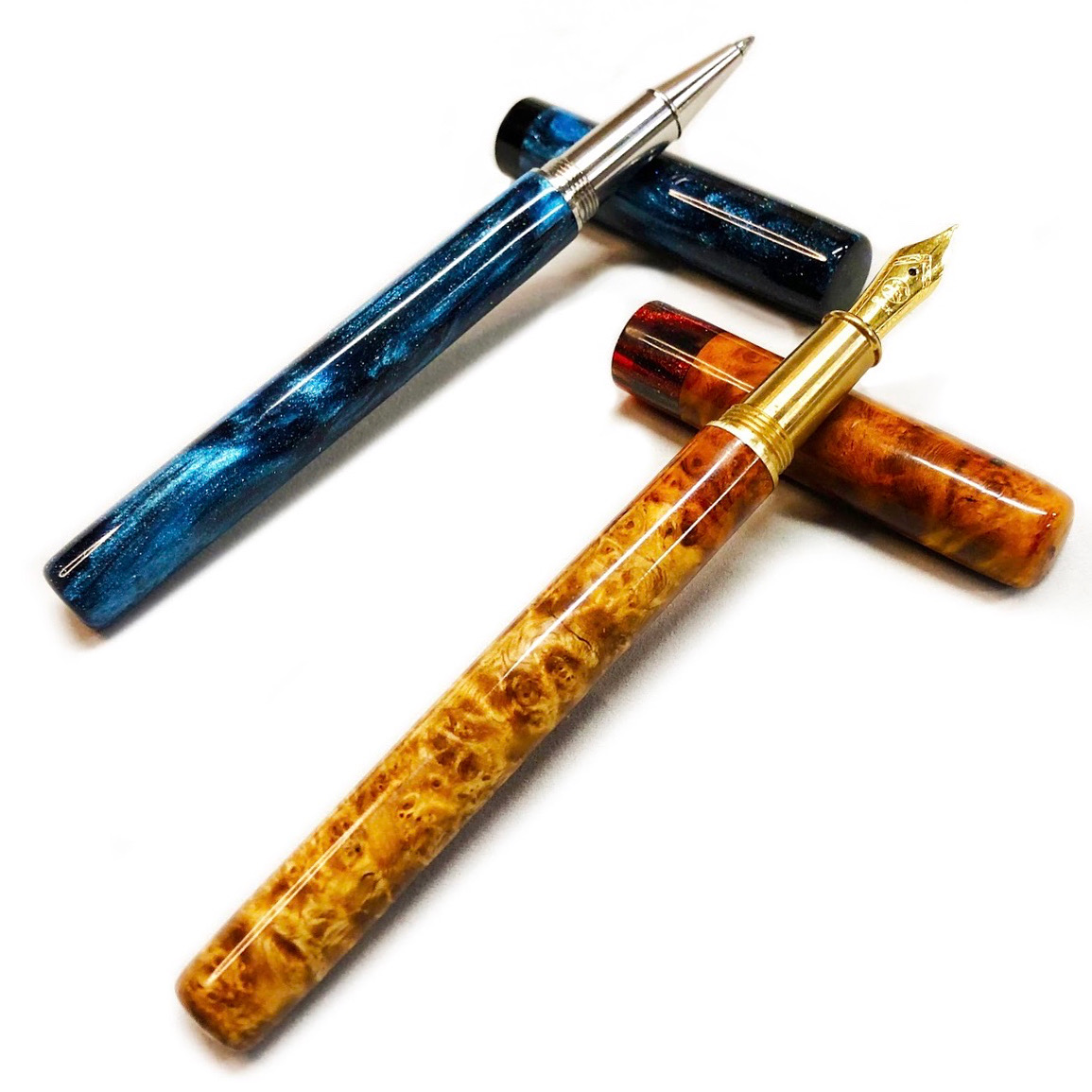

for my closed end pen kits (the Apollo and the Artemis) I often recommend a segmented center band, segmented finials, or both to help get the blanks to a longer size. I especially like mixing mediums and using a wood blank with a resin accent. Can be a slick design feature when done correctly.

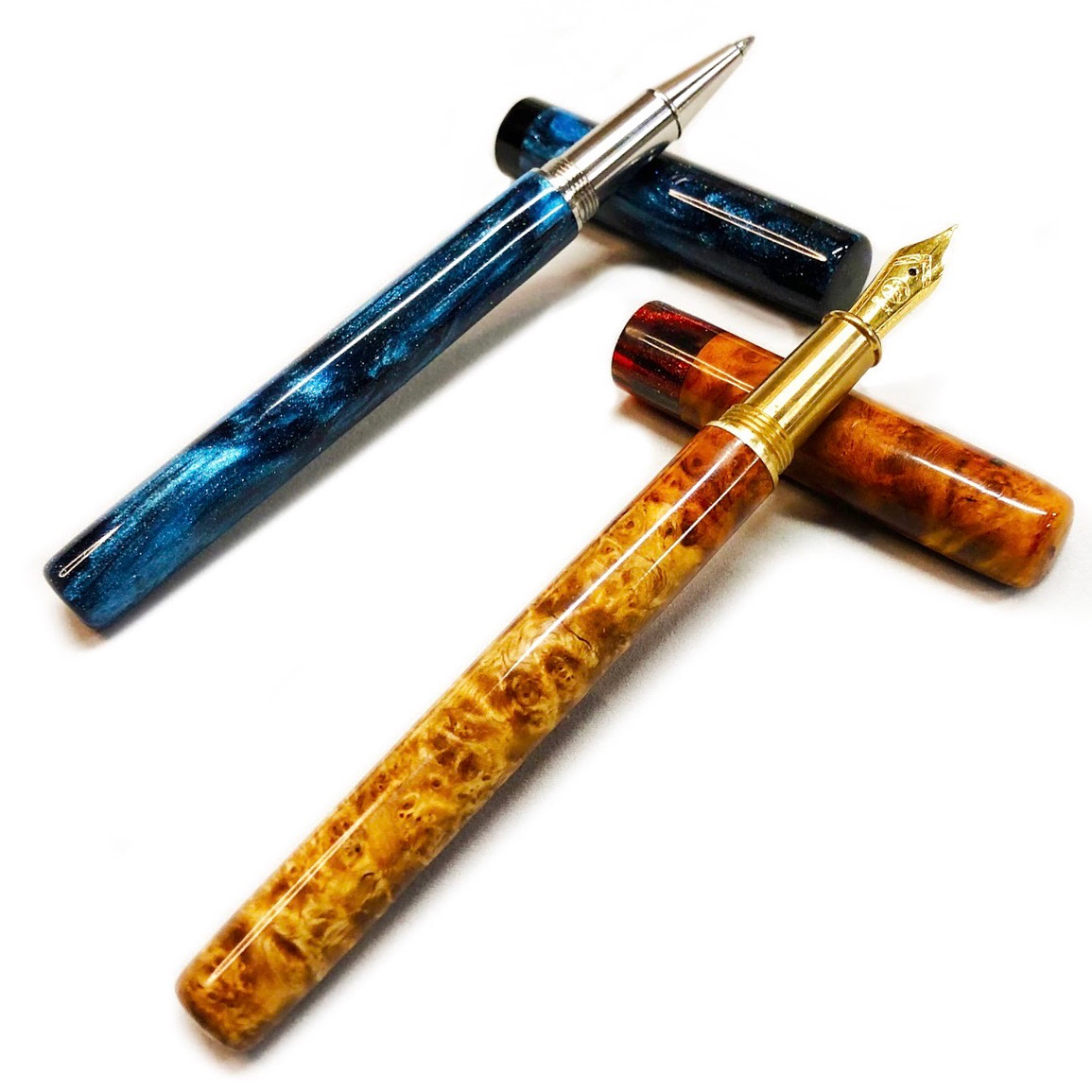

Here's an example I saw here recently—

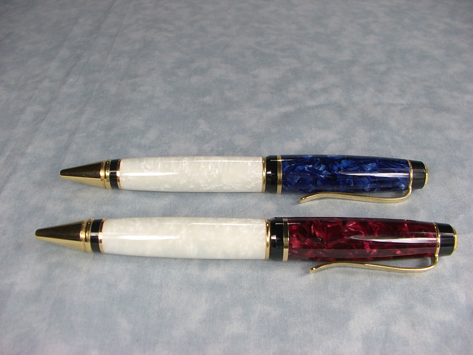

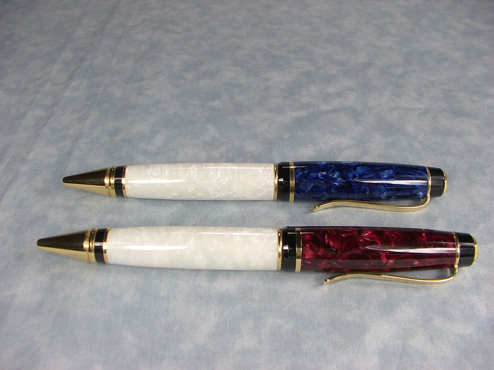

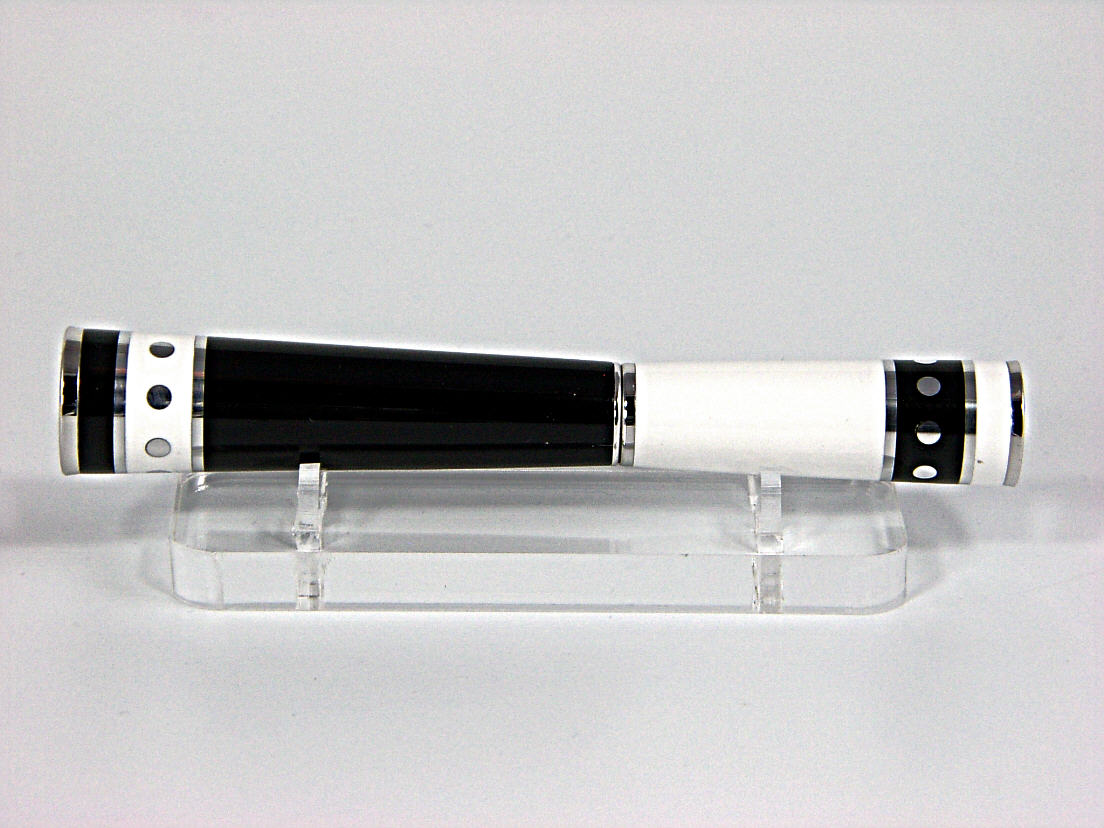

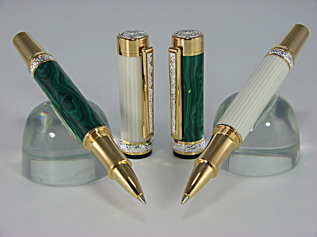

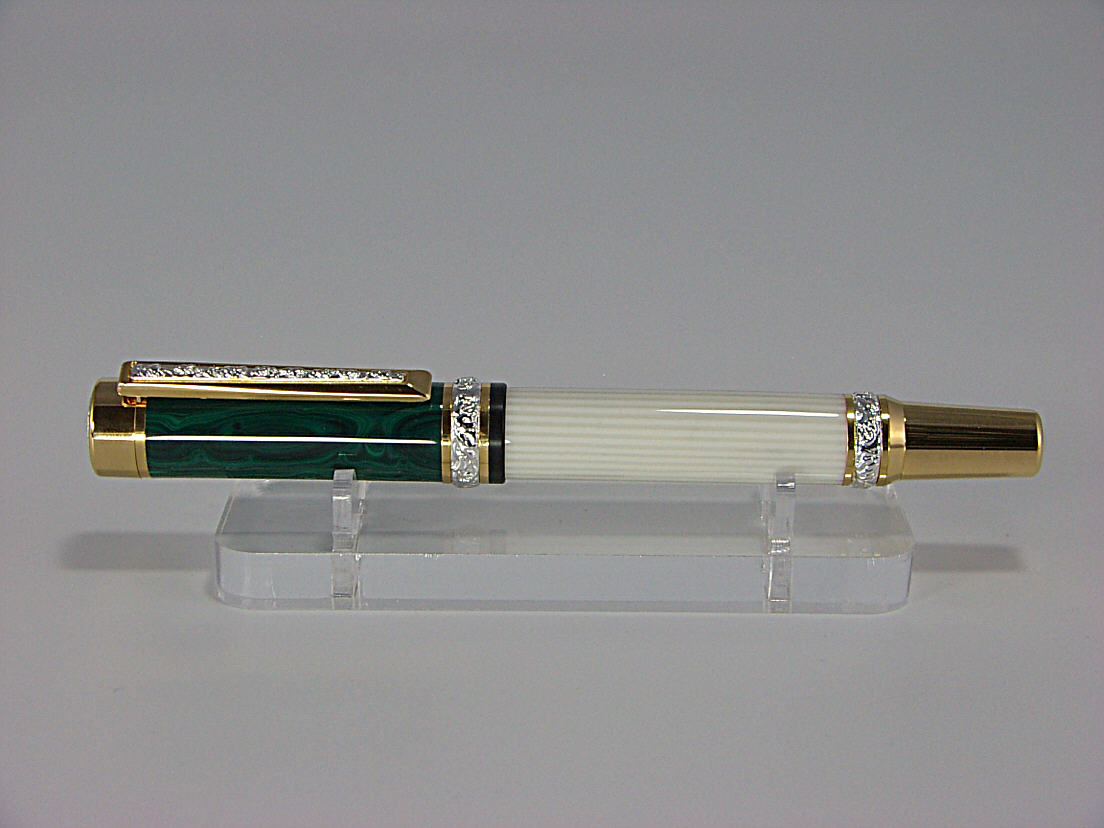

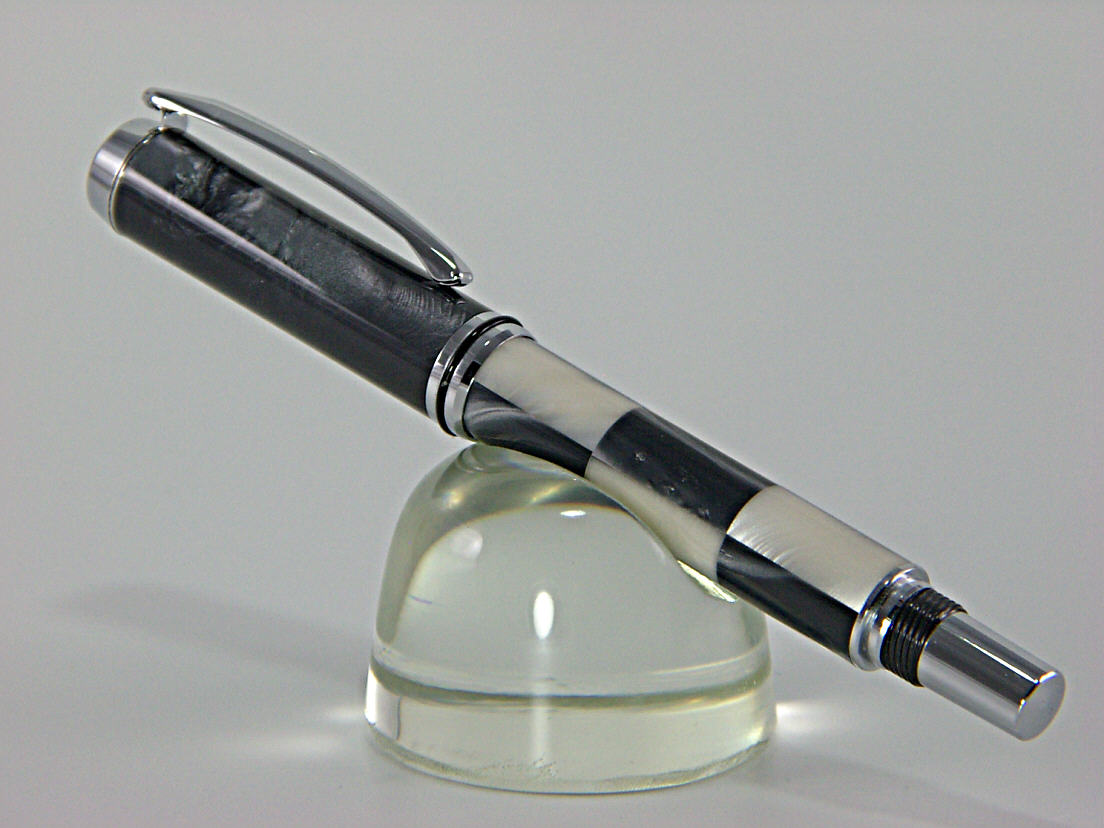

Dave as you seen you got some basic common sense options and there is no way to physically stretch the blank. Any of these ways will look just fine. Segmenting works well. Buying larger blanks or cutting from a source that is a board works well. then there is the use of 2 different materials for cap and body. Do not be afraid to do this. It works well also and gives a different look to a pen. You see this alot from big pen names. There is no law in pen making that says the blanks have to match. It is just a look. an example of a few I did.
View attachment 332578View attachment 332580View attachment 332581View attachment 332582View attachment 332583
Beautiful JT! Gives me some ideas.
