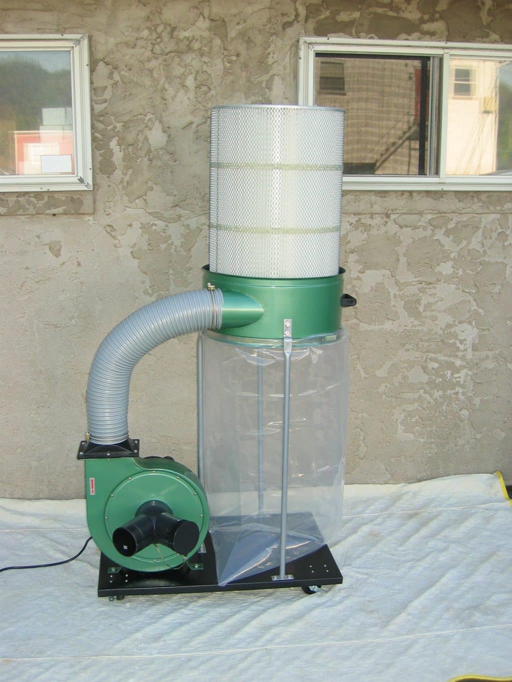

You may want to abandon the 5-micron bag filter and add a pleated canister filter that filters down to 0.3 microns. I have had one of these for 15 years and it works great. I got one made with (I think) polyester instead of paper - this allows me to occasionally wash the filter with a hose.

1. How does the filter fit the unit?
2. Where did you get the filter?
Thanks.
Thanks.
I bought directly from Wynn Environmental (the company attached the link above for). They sell adapter rings to mount the canister filter to the dust collector, but I watched some YouTube videos and made my own adapter out of Plywood. Here's an example video:
Some filters come with an internal dust agitator (it spins on the inside of the filter and knocks dust out from in between the pleats - the dust then drops down into the collection bag. Here is a video about one of those filters:
I also built my own agitator out of some scrap pieces of copper pipe and some stiff plastic sheets.
