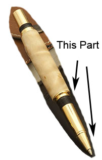

Anyhow, anyone know a supplier that carries parts for pens other than the cigar and the slimlines? Specifically I'm trying to find the nib (I guess you call it) part of the pens with caps like the Apprentice Jr Gent and so on but not having any luck.
Thanks.
Sorry to say you aren't going to find parts like those . Woodnwhimsies only sells slimline/comfort/euro and cigar parts . The parts you are looking for are not available as a seperate parts , only with kits . If you need a single replacement part you can contact CSUSA and if the have an extra they might sell it . If you want them to make a kitless design you should know that some of these kits use oddball thread sizes so you better check that a tap is available for the kits you want the parts from .
Here's kinda the part I'm looking for. I've tried making this part kitless, and aside from the fact I think it LOOKS good to have this part metal (and I don't have a metal lathe). I've tried making rollerball and ballpoint pen nibs in corian and while the rest of the parts of a pen are easy enough I've had poor luck with the nib being drilled out the material near the tip likes to crach BADLY, etc....... Just thought I'd check. Otherwise I'll wait till I can afford a collet chuck which I think will make it alot easier to make pieces like that. May even be able to chock up some aluminum stock and go to it......

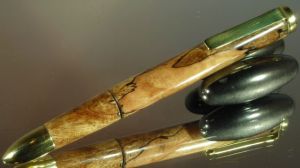

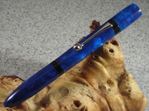

You will need a collet chuck for this kind of work . A scroll chuck will work but it is much harder to use . I make parts like this all the time . They aren't hard to make in Aluminum and Brass but you will find it hard to find taps and dies if you wat to thread it to kit parts , some are standard sizes and some are not . Here are a few that I've made .
Made from black/gold web tru stone
Made from Brass
Made from Aluminum
Made from PR

Rizheng sells the Jr Gent I nibs on their site for a mere 60 cents each. Unfortunately, shipping is a beast for small orders. If you had posted your need last week, I would have added a few nibs to an order that I made. I guess that I should have run a group buy.
I got a shop full of them! The part you show is a Baron or Sedona "front piece". Do you also need the rings and press ins?
PM me with exactly what you need ( plating choices,etc). I no longer make Barons or Sedonas, so, I'm sure I have them in the Sterling, platinum and TN platings.
