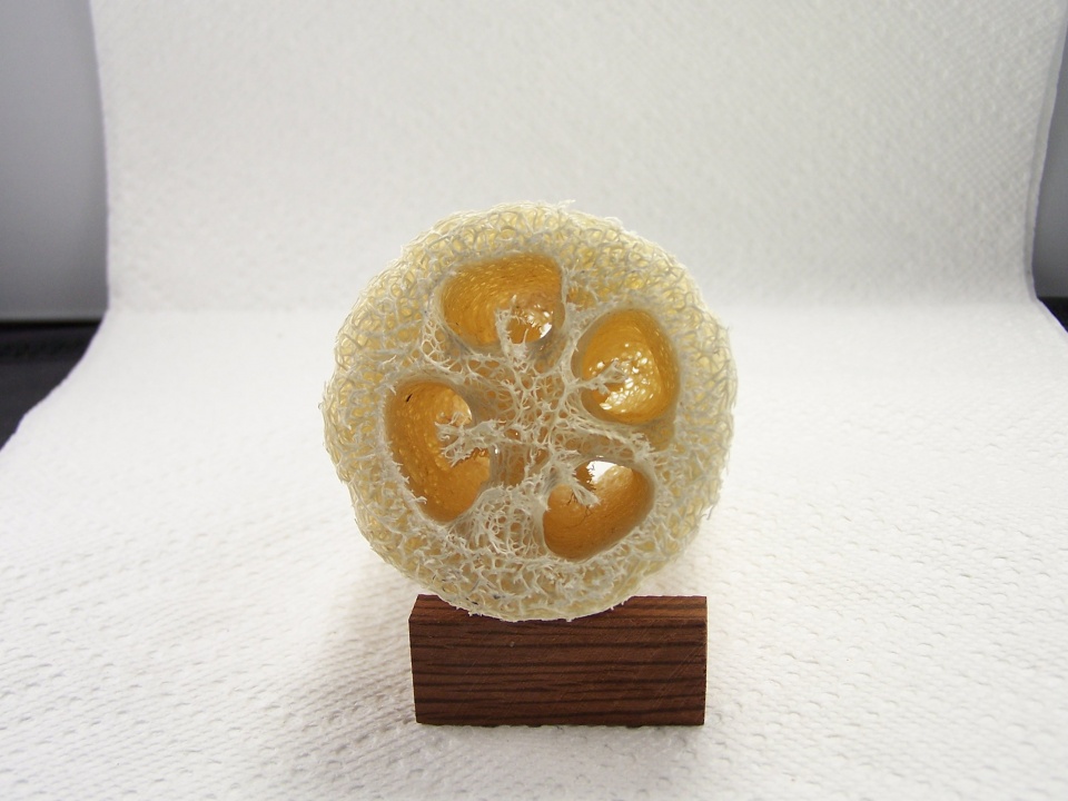

Been reading with great interest the posts on casting loofah.
Bought some on Amazon and have come up to a roadblock.
This is a cross section of what I bought:

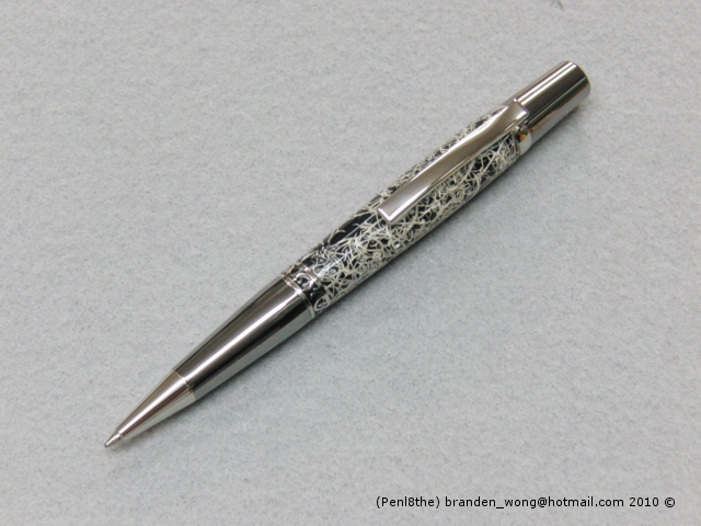

How do I get it down to a thickness that can be placed on a tube like this:
Thanks to Penl8the for the pic that I stole.

Remove the center and the cross pieces, leaving only the outer rim.
Slice the outer rim lengthwise on ONE side.
Unroll it.
If one thickness isn't enough....repeat as need and stack them on top of each other to the thickness desired.

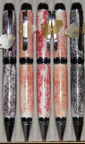

Core out the center. Cut the remaining into strips and fit in a blank mold. Pour clear pr and cast the loofah into blanks. When you get ready to turn paint the inside of the drilled blank any color you want. Black is very dramatic as is red. Did this a few years ago and sold the pens immediately. Good luck.
edit: here is the link to the ones I made and posted here on the IAP.
http://www.penturners.org/forum/f13/my-first-cast-no-they-not-cactus-49570/

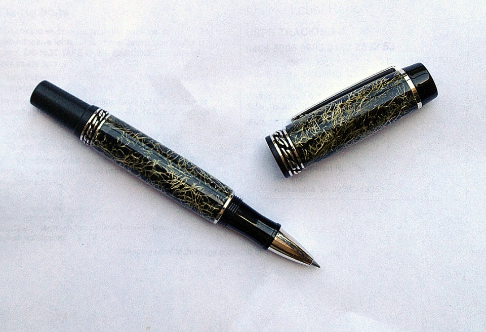

Here is the Loofah pen I made today. On this one I learned from my mistakes and painted inside the blank rather than painting the tube.
It turned out pretty nice, but there seems to be a bit of separation in a couple of spots at the ends of the blank. Also, I cast it under pressure, but there were still two tiny air bubbles that did not resolve. I filled them with CA when I was turning the blank, but you can still see them as little whitish spots. Is there a trick I don't know about to fill pinholes and have them blend into the clear resin?
Sorry for the lousy photo. I am working on a setup that will work much better. Baby steps...
Steve
