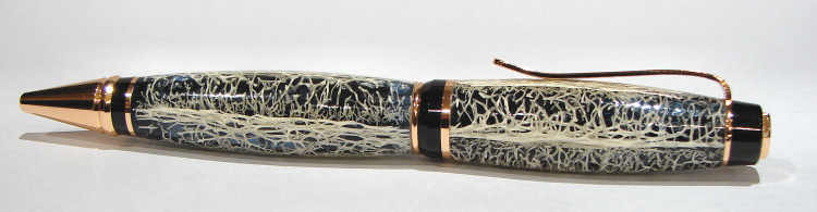

It has been mentioned a fair amount here, usually in relation to cactus pens. Well, I finally got ahold of a loofa and cast it this evening. Here is the results. It was cast with Alumilite clear and I used dark blue tinted epoxy for the glue and to cover the tubes.

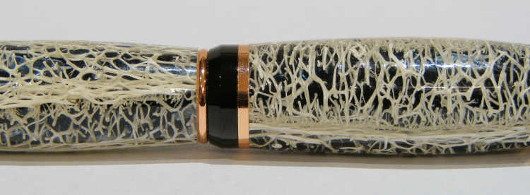

Here is a close-up
Looks great! I think it would look even better if the sponge were dyed red. Would look almost like veins.
sarah,
Go to the home page here at IAP and click the link for my tutorial on making cactus blanks. Just substitute loofa for the cactus.
Alumilite is a clear urethane casting resin this is a lot less stinky and less brittle than PR!
Skye,
I am not sure if it would work to dye the loofa. I know I have tried dying the cactus skeletons and they did not take the dye. I tried red, black, and blue Transtint dye both diluted in alcohol and straight and it did not take. I guess I will have to try the loofa and see.
MDWine,
Just about every place you see the white! The loofa is placed in a 1x1x6" square mold and resin is poured in. It is then turned just like a wood blank so yes, I am cutting through the sponge the entire time. Same with my cactus blanks.
Another nice pen Curtis.
I've been planning on doing this (cast Loofah) for more than a year now...but you actually put it in action and not just plan. You're the man! [;)]
Great job! Glad someone finally shows us what it looks like!
I think you're right that the cactus looks better... Though I'd take the Loofah over the cactus for the amount of work (and stink) it takes...[;)]
Dang, Curtis, you beat me to it! I picked up a nice piece of the stuff from Wally World while I was in Houston earlier this week, but haven't had the chance to cast it yet. Looks great!
