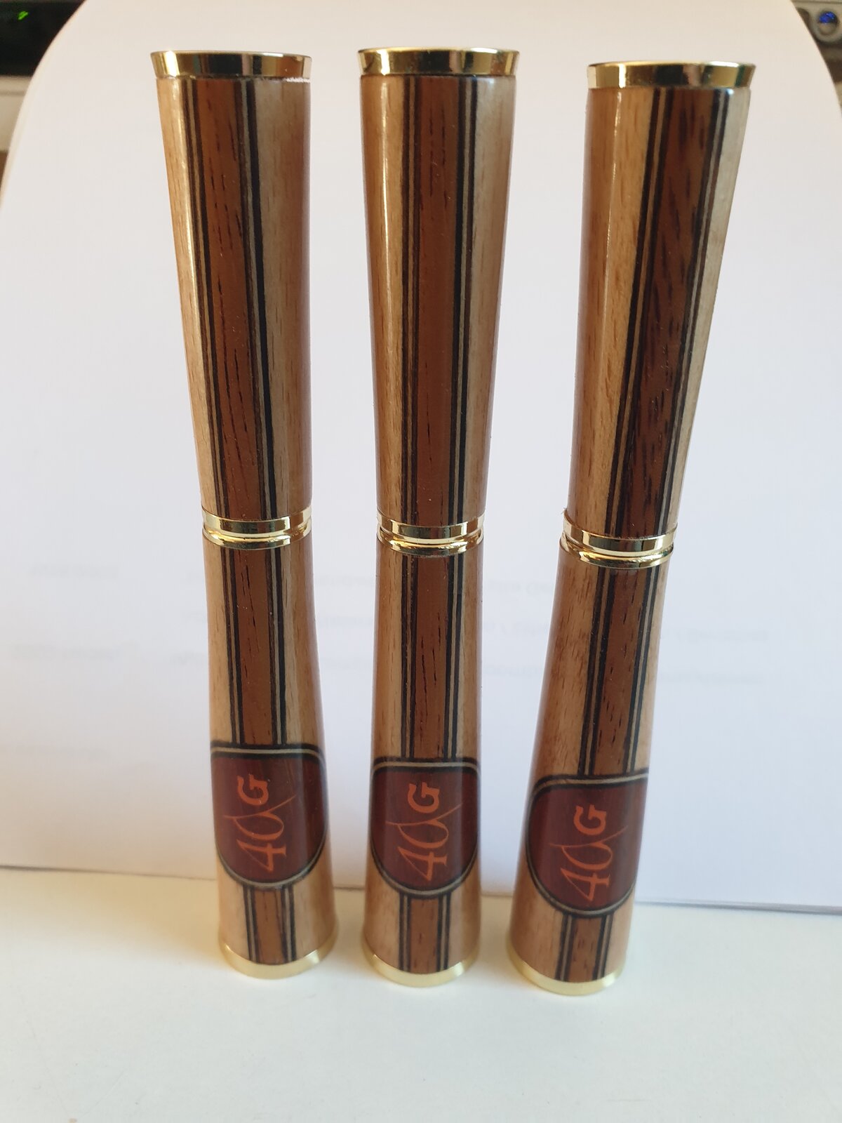

Some time ago i asked here how to put text on a pen, or a logo.
Decall was a answer, so i searched and asked around what others do.
Then my daughter who has a hobby material shop, said to me "i can cut logo's, very small out of a colored sheetplastic material."
Ok, lets try it, not expensive at all.
I made 3 pens for a neighbour that needed a logo for a 40 year existing jubilee.
Ofcourse segmented, panache pen kit. beech and meranti. beech and wenge veneer, azobe medallion.
The sticker is 100 micron thick, transfered on to the medallion and drowned in CA, 3 layers of thin, 7 or 8 medium
