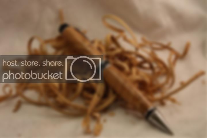

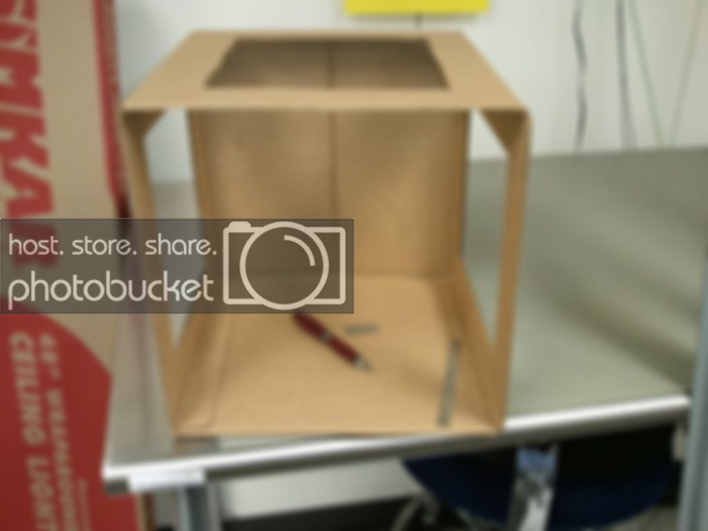

I just built this today:

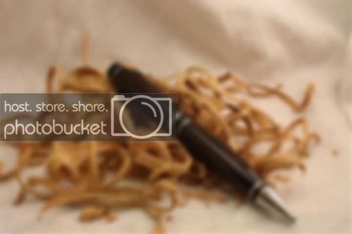

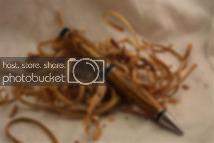

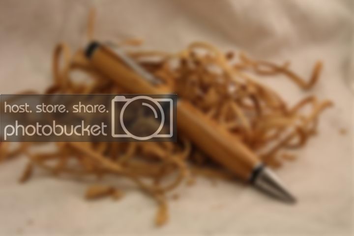

In that last image, I haven't yet set up the lights around it. Here are some of my first shots. I need to play some more, but for the cost (nearly free), it can't be beat! The "windows" are covered with an old cotton sheet I cut up and taped into place.
Nice box. that must be fancy corrugated maple. :)
i am really glad you showed me your box. i tend to over do things and seeing that brought me back a bit. i guess i dont really need a fancy rig when a simple box will do. thanks guys!

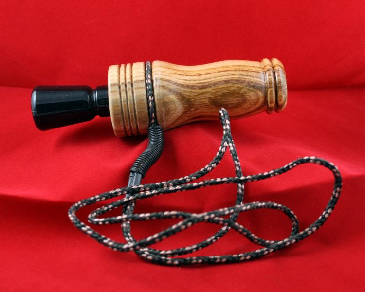

Use a Photo tent they are available in a variety of sizes and the kits come with lights. The kits on eBay will run from $50.00 to $100.00 for the smaller kits. With these kits turn off your flash and extra lights help. Use the proper temperature bulbs, not household bulbs.
Day light Photo bulbs
They run a daylight balanced color temperature of 5500K 5600k and 5700k range. Get low wattage 45w or lower. You can get them at any photography site they run about $20.00ea. With good lighting you can take great photos. A big problem I see here is lighting and getting to close to subject, take a step back and crop post production.

Hey brad, i couldnt see in your photo. what did you do for a light source?
The setup I used isn't what I'm going to stick with. For these shots, I used a couple of small lamps, removed the shades, and propped them with books to the sides of the box. Then I took a floor lamp and rigged it to hang above the box.

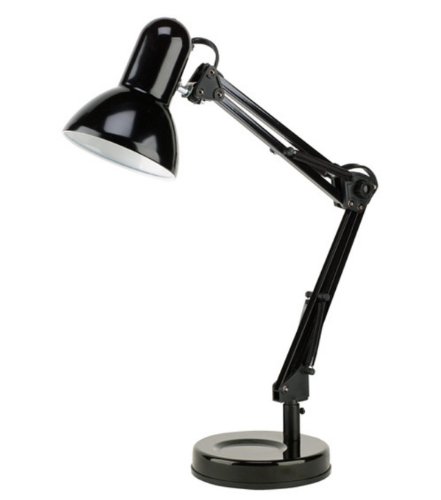

When I get back from a trip in a couple of weeks I'll go buy some articulated desk lamps likes this one:
They can be "aimed" at the windows on the box.

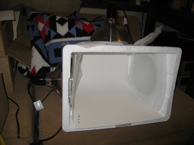

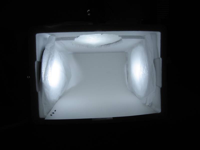

I made a light box setup for under $30 that works nicely for me. It is based on a white Styrofoam cooler (the cheapest one I could fine - about $3). I bought 3 inexpensive utility clamp-on lights. The kind with the big round aluminum reflectors similar to these. I removed the clamps. I cut holes through the "top" and both sides of my lightbox large enough to hold the light reflectors by friction fit. The top light just rests on top of the hole, taped in place. I then taped white tissue paper (the kind you wrap gift items with) inside the box over the lights. I used a double thickness. For the background, I use a piece of white poster board curved inside the box so there is no visible corner at the bottom back. I planned to experiment with other colors but white looks great so I never got around to other colors. I placed daylight fluorescent bulbs inside the fixtures. I think they were 40 watt equivalent (10 watts on the bulb).
I use a second piece of white posterboard handheld over the front of the box. This piece has an oblong hole cut into it to put the camera lens through. This reflects a little more light from the front and lessens the amount of dark reflections on the metal parts. I initially used a tripod, but this arrangement puts out more than enough light for easy handheld shooting with image stabilization so I just shoot all handheld now. I use a little pea-sized ball of Blu-Tack to hold the pens with the clip up. I can remove any of this that shows in the photos using GIMP. I've used this arrangement for all of the photos on my web site.

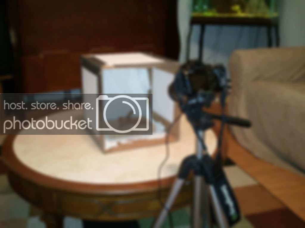

Some scrap plywood a few lamps and this is what i came up with...
i had some scrap lexan that i sanded with an orbital sander to filter the light. here are my first attempts at some new photos...
Ray--
Your first two shots are a bit dark. Are you using a manual camera or point and shoot?
Your third appears a bit "soft". That might be a function of you compression program, though. It doesn't show enough sharp detail.
How are you standing them up? Is that a nail or a tack I see?
i thought they were a but dark too.
i have a point and shoot camera. i dont have any good photo software. i do have paint shop pro but i dont think it is geared towards this.
and yes, that is a nail. :biggrin:
