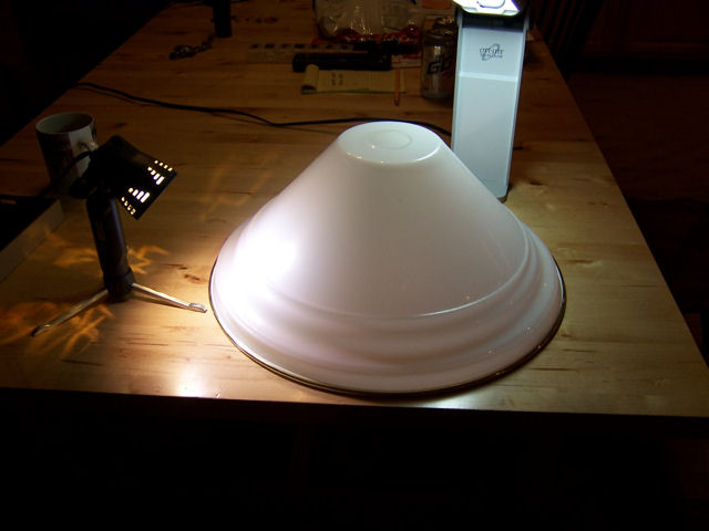

light shade
Here is a very "lo tech" device. It came from the Goodwill for $1.00.
Lights can be adjusted around the unit. Camera on a stand and the photo is shot through the hole in the top with a grey card on the table.

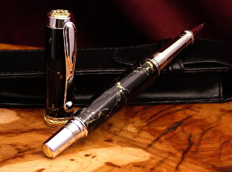

So far, the setup is working fine for me. This pic is in an 18" tent, 500 watt
worklight directly overhead. There's a chunk of cherry burl on the bottom
and a piece of maroon fabric hanging up in the back of the tent with a
few clips.
