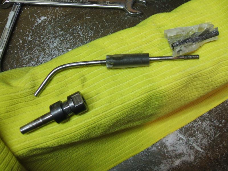

This is an example of what NOT TO DO, or should I say DO! I'm always one for attention to detail, but tonight I wasn't paying attention & my tailstock wasn't as snug as I thought!
New Adjustable Mandrel = $22.00 + shipping
Trashed Carbon Fibre Blank = $15.00 + shipping
Lesson learned...................Priceless.
No injuries ~ only my pride.
Play safe out there boys & girls.

$37.00 and no missing fingers. As far as I see it you got the lesson cheap. I have done this as well. I have a huge trust issue with tail stocks now. I have a little grab the mandrel and yank on it thing I do now before I hit the switch on my lathe. just enough to feel that tail stock end move if everything is not set up right. That bent mandrel reminds me to much of 12" diameter brush cutting weed whacker.

Well, the tailstock just backed off ever so slightly..........then the mandrel starting it's death spin..........and by the time I realized it, the shaft was whipping around until it came lodged between the tool rest, and the lathe bed.
What a freaky accident. I couldn't even get to the switch in the amount of time it took! :eek:
Yeah, How does this happen? Still new, and don't want this happening!
