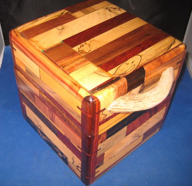

We all have those blanks that aren't quite interesting enough to make a pen out of. So what do you do with these extra blanks? Make a box! I put these spare blanks together and made a box that is 6" x 6" x 7" deep. No nails or screws except in the hinge and the antler handle, just dependable old CA. Corners are Cocobolo and it is lined with black felt. I'll probably make a lift out tray to fit in it. Didn't hardly make a dent in my old blank box.....maybe I better make a bigger one next time.

I just stacked up the blanks, glueing as I went. When it was 6-7" tall and had dried for a couple of days I ran it through the thickness planer to level all the blanks for the inside and outside. Then I sawed it up into sides, top and bottom. I glued them all up into a 6 sided box and then sawed off the top on the table saw. Five coats of gloss polyurethane, a hinge and an antler handle and voila, a box!! Keeps me from watching TV all day.
