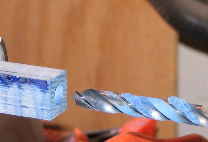

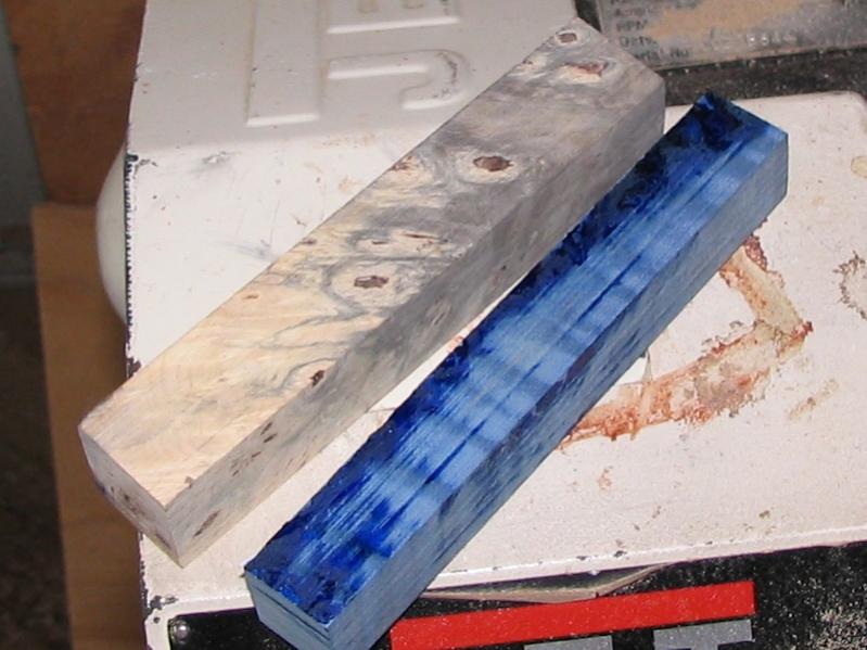

Constant sent a couple of blanks from his new eco-friendly stabilizing process. I'll leave it to him to give the story behind the stabilizing.
First, the blanks are large enough to make any pen. The exterior coloring is very nice and consistent. There is no noticeable odor with these blanks.
Cutting and drilling went smoothly, although the blanks seem to be a bit denser than average...a good thing in stabilizing. Again, there is no noticeable odor.
Turning went smoothly and, for me, relatively effortlessly. The density may have cause me to touch up my skew one extra time.
Sanding is interesting. It produces a lot of very fine, powdery dust...almost like drywall dust. Fortunately, my DC and air filter seemed to handle it with ease.
The picture below shows two halves of the same blank, one which was simply sanded to 600 grit and the other which was given a light buffing. You can see from the shine lines that the process clearly penetrates the wood thoroughly and that the dye is evenly disbursed.
In short, I thoroughly enjoyed working with these blanks and they produce some beautiful results.

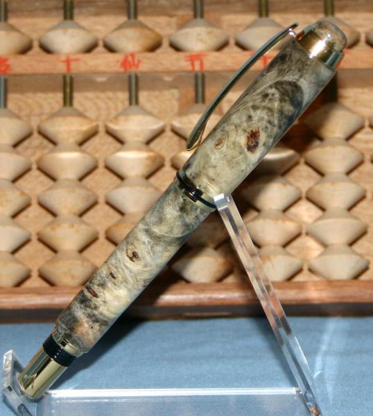

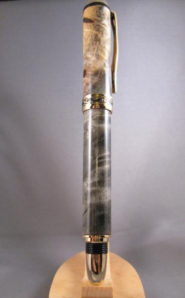

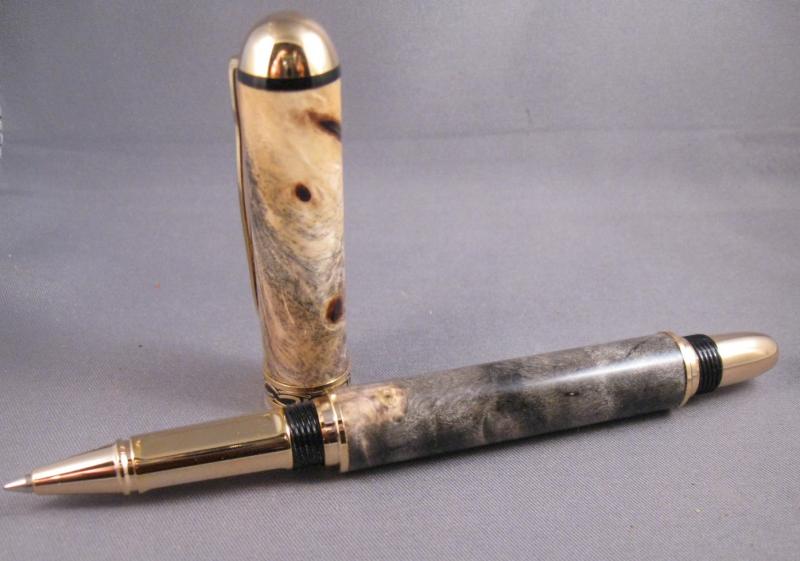

I have to agree that these blanks turned well. I used a Buckeye Burl and only had time to turn half of it today but it went great. The blanks seem very solid all the way through and turned into a powder for me as well.
There was no noticable odor while turning this blank which made it a bit more pleasant too. I sanded mine to 600 and then hit it with the buffer quickly and it took a great shine without any other finish applied. The pen is a full sized Gent. I'm looking forward to turning more of these.
Edit: I turned this with a carbide tipped tool so no sharpening was done during the turning but it was ready for sanding right from the carbide tool.

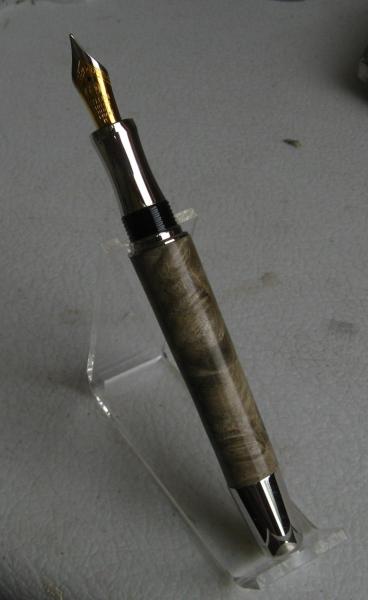

My clear (non-dyed) blank is turned and the finish has been applied. I think it will look great. I should be able to post it tomorrow. I will say that I have "relearned" something. If you are one who tries to fill in cracks and holes with sanding dust it doesn't turn out as well with stabilized blanks (and that is all of the ones I have tried this with not just Constant's). The dust is more white due to the stabilizing material.

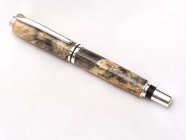

Ok here are a couple of pictures. The first is side by side of the New style and the old style stabilized buckeye burl. The second is of the Gent that I made with the new style. I will say it appears that the new blanks have less of an amber appearance than the old way.

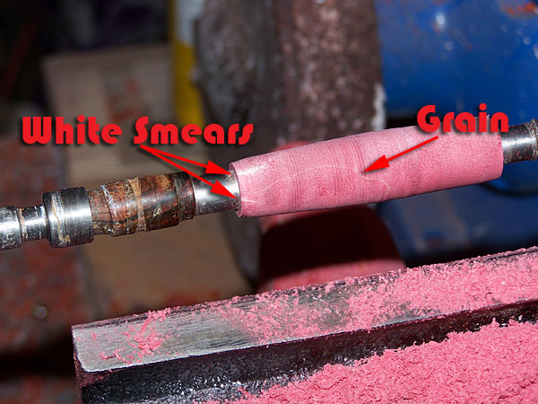

I turned the curly maple blank. I don't know that I like the negative grain effect. And there were white "smears" at the ends as well. It didn't seem happy with CA for gluing in the tubes, but a CA finish worked fine.

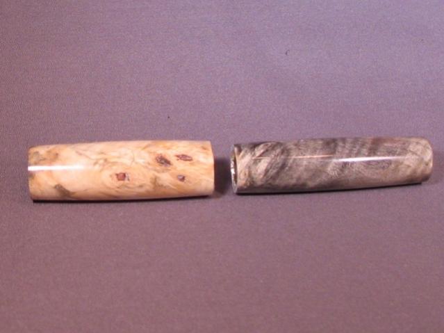

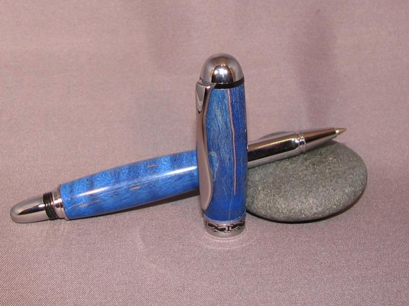

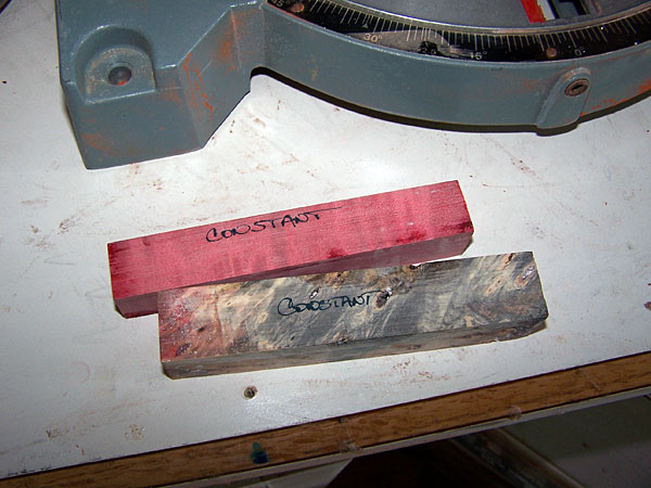

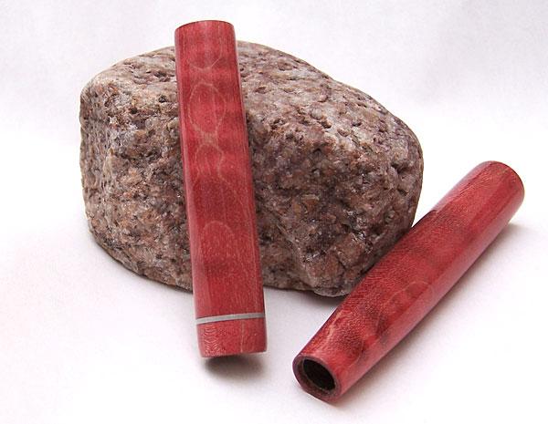

I finished my blanks this morning. Attached are a few photos. Both were cut to size on my band saw, no problem. I drill on the lathe and again no problem. The blue blank seemed harder to drill than the buckeye and I had the same impression when I squared the ends. I turned the corners off of both with a small gouge and then switched to the skew. Both produced fine dust-like shaving and had no smell. As you can see, the color penetration was good on the blue blank. Both were sanded to 600, CA, then buffed w/ EEE and WD.
I had a problem w/ the buckey but it was me, not the blank. I had a catch and tore out a chunk of the cap. You can see the repair line in the 4th photo. It is on Jr. Gent tubes. I have not decided if I will assemble it or not.
I made a kit change after I glued in the tubes on the blue blank. It was originally going to be 2 Sierras. The difference between the hole sizes on the lower barrell on the Sierra and the Sedona were 2/64ths so I glued in a Sedona tube on one blank and drilled out the other one for the cap. The point of tellin you this is that the wood on lower barrell on the Sedona is thinner than normal. In addition, I dissassembled it once and put it back together. It held up well under a stressfull process. Maybe the double layer of brass tube helped too.
the big question: yes, I liked them both very much.
The main question is: Would I reccommend these? Absolutely.
The grain is what it is with Maple/Curly maple and the stabilizing and dye will not change it. I have left some pieces under pressure ( 3000 psi) for up to 60 hours and the result is identical. If white shows after it is stabilized by me it will not take the dye.
You can test it with a black light to see how well it penetrated the wood.
I have not come across any problems with the adhesion of the brass tube with CA.
Please keep posting the results.
Those smears weren't grain. I understand about the grain, I just can't figure out what those smears are. They were pretty deep and consistent, which makes me think it's something goofy with the wood itself.

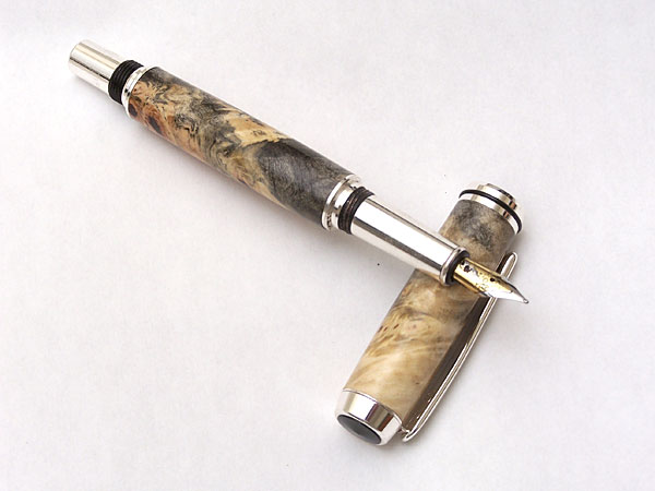

Finished the burl tonight. It smelled more like the stabilized blanks than I'm used to... Different formulas? Or am I more sensitive for some reason?
Anyway, some chunkout in the inclusions, but I was able to turn past them (should have switched to the skew sooner). Otherwise, turned much like the maple did. Nice to have the two drastically different woods turn consistently. :biggrin:
CA finish and my daily driver sterling silver Navigator hardware. I didn't clean the nib or anything. I was never happy with the gray and red anyway, so this gave me an excuse to screw up the plastic threads in the cap. I mean replace the barrels. Grrrrr... :wink:

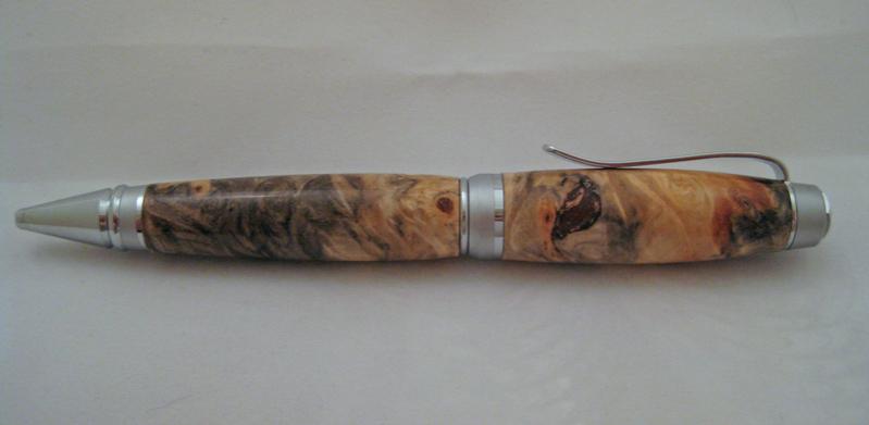

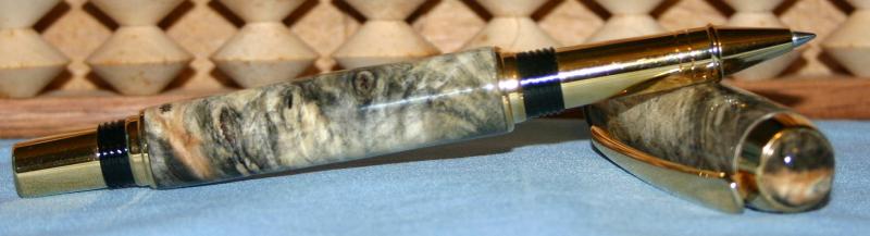

I also recieved 2 of Constances blanks one a blue maple and the other a Buckeye Burl. I put the Buckeye Burl on a Gold Sedona Kit.
This was one of the nicest, easiest stabilized blanks I have turned, albeit I am new compared to some here but I have turned a few. First I glued the tubes in with CA after drilling and while drilling I noticed no nasty smell coming from it like most stabilized or acrylics. Turning the blanks creat small chips and alot of dust which was hot on my finger but I had no chipout of any kind or catches at all. I was able to turn it to size and sand a little after using a skew as a scraper.
The finish I used 3 caots of medium CA to see how it would react and there was none and it was smooth as well. I wetsanded through the top 6 MMPads wet and it polished like a dream. IMHO this is a great product and anyone should be able to get a great finish and turning out of it.

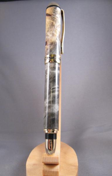

Constant also sent me a few of his new blanks. I haven't turned the blue one yet but did turn the buckeye burl. As everyone else has already said it turned very easy with no order to speak of. I used it to make a Jr Gent and it's one of the nicest looking pens I've turned in a while. I'll be buying some of these for sure.

I finally turned my buckeye blank today. I will try to post pictures later tonight.
I love the stablizing!!! The blank drilled, turned, sanded and finished better than any I have turned. The smell reminded me of ripe bananas.
The finish is absolutely amazing. The way the buckeye and the dyed maple take a CA finishe, makes the color pop!
Thanks Constant!!!!
Thumbs UP - Great Blanks Constant!!!
Here are the pictures, I promised.
Thank you Constant!!!
This blank was a joy to turn. I love the way this blank takes a CA finish.
