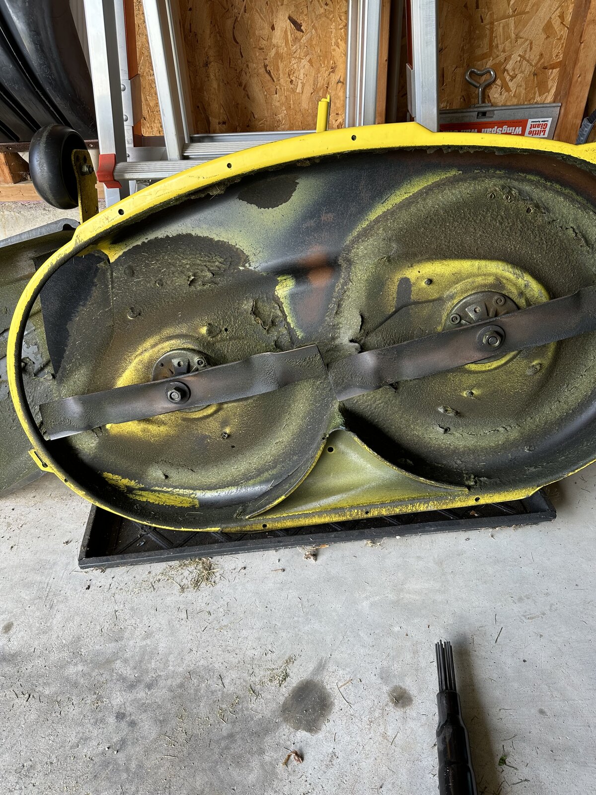

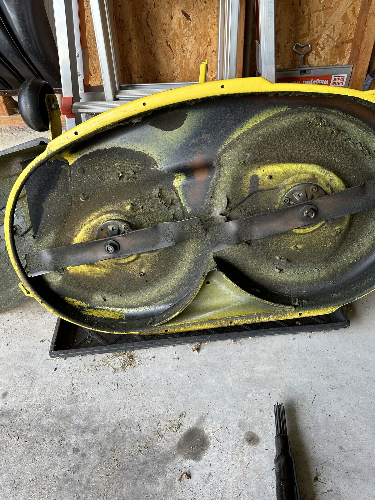

Last fall after cleaning the bottom of the mower deck, which took hours, I coated the entire surface with dry lube spray. Oh my goodness, what a difference this year. Look in the picture, there are huge areas that nothing stuck at all and the cleanup, this year took maybe a half hour. I've heard about it in the past but didn't think it would do much. I sure was wrong.

Then, at the end of each mowing season, I replace the oil, air filter and spark plug and drain the gas. I also remove and sharpen the blade, and then spray a coat of WD40 on the underside of the deck. The WD40 means that I will start the next season with a clean mower deck, which means that it picks up less grunge each time I use it.
What kind of dry lube spray? I've tried spray wax like Pledge but it didn't make a big difference. Have about 4 or 5 acres to cut and it builds up fast.

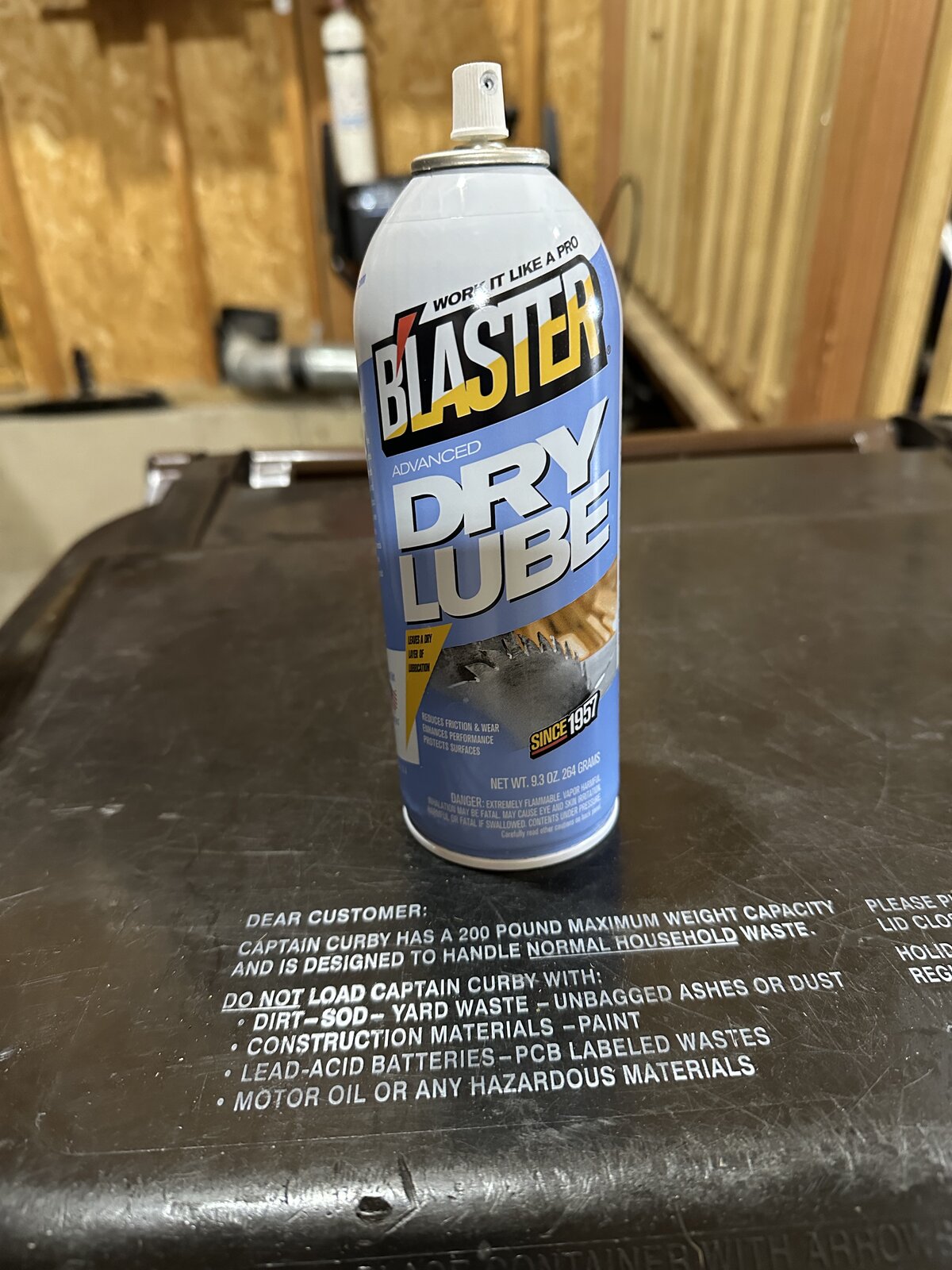

i used this
This sounds like a very good idea. I have wondered why they don't make the decks with a teflon or ceramic coating. While I don't see it on the can Ken pictured, the one I found at HD specifically shows "Teflon" on the label.
Then I saw that DuPont makes one that has the ceramic non-stick in it.

On the one I bought, it specifically called out mower decks. Probably any brand would work.
