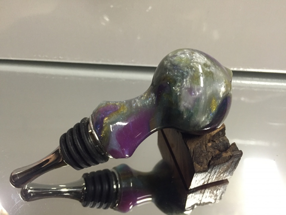

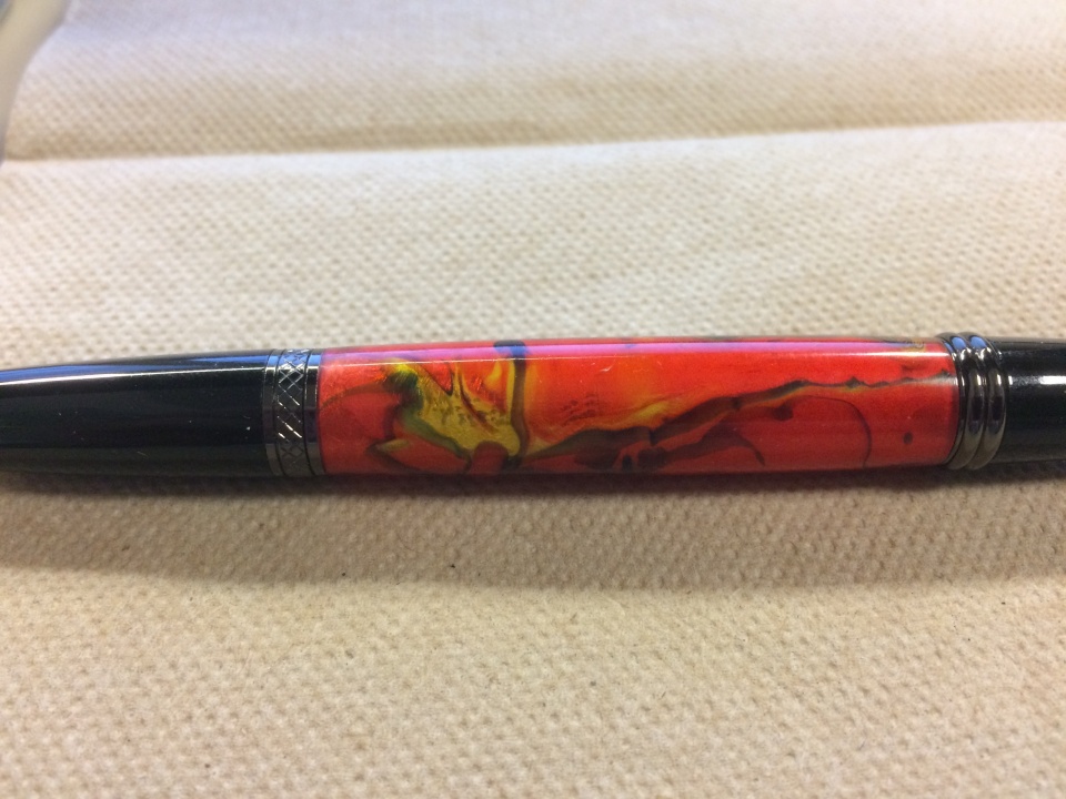

Did a pour last night that got me much closer. Waiting nervously past the 5 minute mark, 6 minute mark, kept testing consistency, when it was just sort of slushy I poured the colors and slightly swirled. I'll open the pot when I get home from work tonite.
This will likely be the last pour of the season for me. I don't like to pour in the house and it'll be too cold in the garage for comfort soon. Beside, I have an album to record and winter is the perfect time for that kind of inside stuff. Anyway, if this pour looks interesting, I'll post it. If it doesn't, well, i'll try again in spring.
I'll grab better pics, but this is off the corner slice. I quickly drilled and turned it last night so I could see the finished product. The center has better (more vivid) colors and better separation. What I love about casting is how the shavings all have different colors that never seem to match the finished product. For this one, the shavings were pink, and light blue. Almost Easter colors. The finished blank is more of a Halloween look. This finished off my Alumilite and there really wasn't enough to do the double pour that I wanted. However, I'm encouraged by this warm autumn weather, so I'll order another batch and see what kind of effects I can create.
