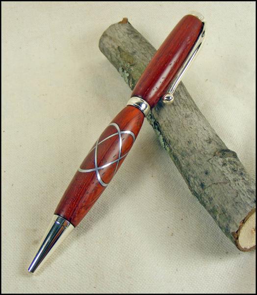

I'm attaching a photo of my first aluminum segmented pen that was made last summer with Padauk and aluminum. I have learned a lot about sanding aluminum since making this Slimline. I've also learned how to use my skew so that very little sanding is needed.
