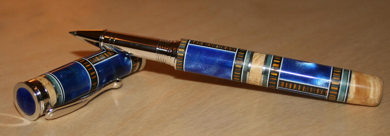

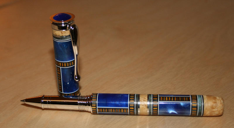

Here is my latest effort. I am a bit sad on this one because it broke at the segments about 10 times and I inadvertly glued it back together with the horizontal segments mis-aligned. I did not notice until I pulled it off the lathe. It was a lot of work and I am very bummed out that it turned out this way. I guess we learn from our mistakes.
It is a Jr. Retro closed end and I replaced the stock black finial button with one that matches the blank.

Nice job hebertjo, you can always pretend it wa supposed to be like this in the first place!:rolleyes: Frankly if you hadn't said anything I wouldn't have picked up on it. Like the custom finial and good job on the closed end work.:RockOn:
That is very nice. The colors and the design go together very well. Don't worry about the alignment, looks just fine from here.
Just don't tell the customer.....
When I make special pens, I have a printed list of "Things to watch out for"!:eek:
Don't ask, don't tell!!!!
It is excellent work and well worth showing off!
Your design and color choices are very nice. It is disappointing when a segmentation doesn't come out the way you imagined it, but you still have a great looking pen.
Very nice-looking pen! Personally, mistake or not, I like the fact that the segmentation is offset. IMHO, if they lined up, the pen would appear too regimented and contrived; this way, it looks sort of patchwork, and I like the effect! Great job.
Beautiful pen. I like the offset horizonal elements. Do you mind telling us what materials you used for the segments?

louisbry - The blue is cobalt blue from Woodcraft (I love how easy that stuff turns) The metal is 1/32 aluminum and there are some 1/16 inch bands of blue dyed box elder burl. Also, natual stabilized BEB and the blue and yellow-ish segments are from a bottle stopper blank from Penn State called Oceana.
I looked at the pen before reading and was amazed. After reading what you wrote I had to go back and look again. Took me a while before I saw it. I think it looks better this way. Great work.

What an amazing looking pen. I noticed right away that the lines were not lined up and was even more impressed by that. I really think it looks great the way it is.
