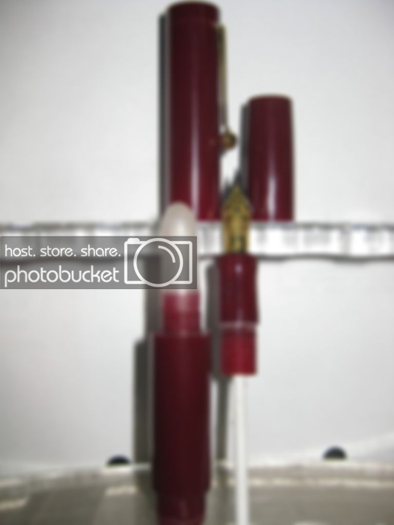

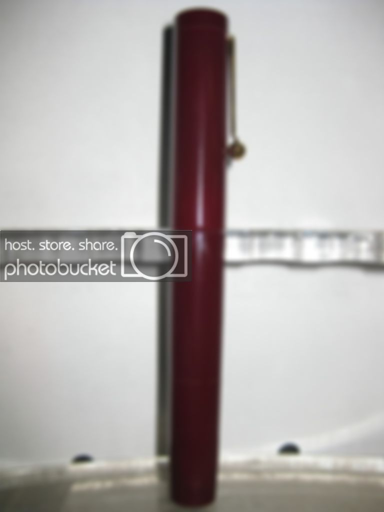

I was able to get this one done this morning so I thought I would post her up.
I used an old Bic BP refill cleaned out for the breather tube and it seems to work really good.
Chris
Ok, your eyedropper pens fascinate me. This one is no exception. Would you mind sharing how it works? I'm curious to know how the ink makes it down through the feed into the nib.
Thank you
You have to have a second breather hole to allow the ink to flow into the feed as the breather tube is to help filling.
Chris
