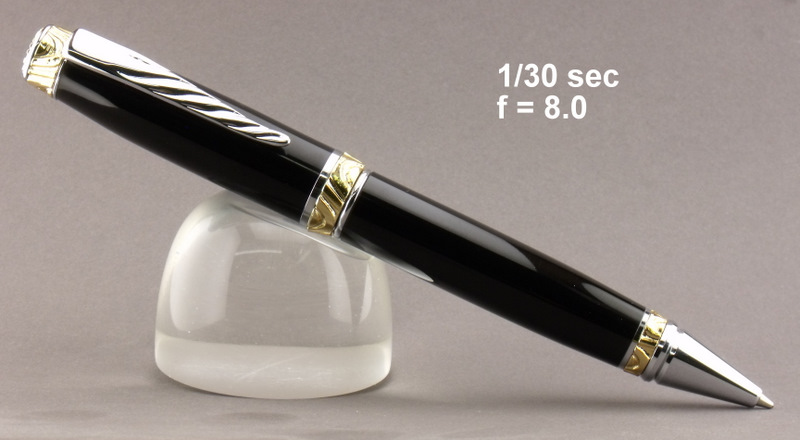

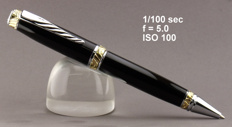

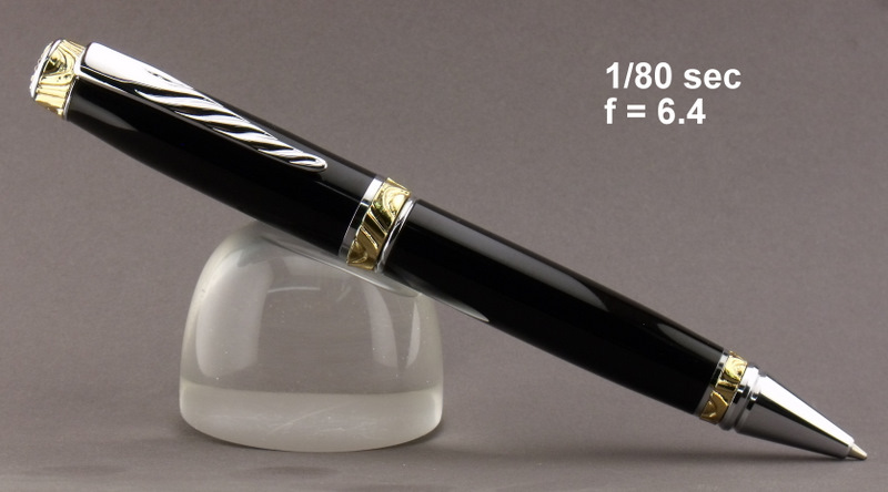

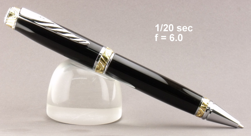

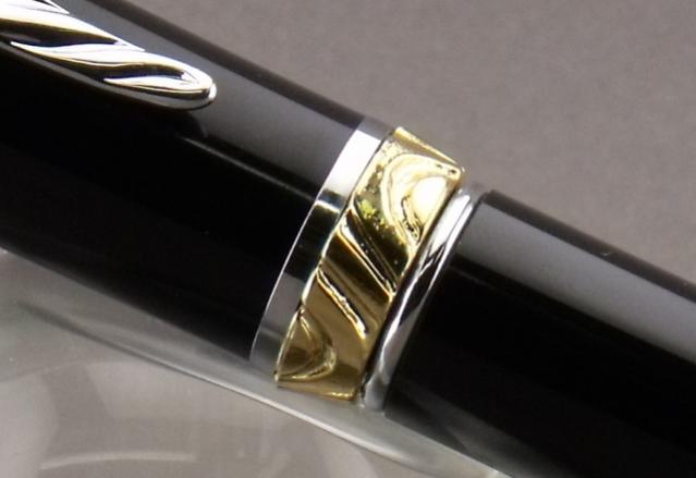

Finally figured out how to resize in Picasa:rolleyes:
Please tell me which is heading in the right direction:smile:

I really like the middle one. The background color helps both the dark and the light highlights stand out very well!
The first one isn't quite fully in focus. The finial end is kinda "soft".
What are you using for a metering mode? Average, center weighted, spot etc. ?
Along with all the other good advice you have received you might want to experiment with that, in particular try using "spot" mode.
