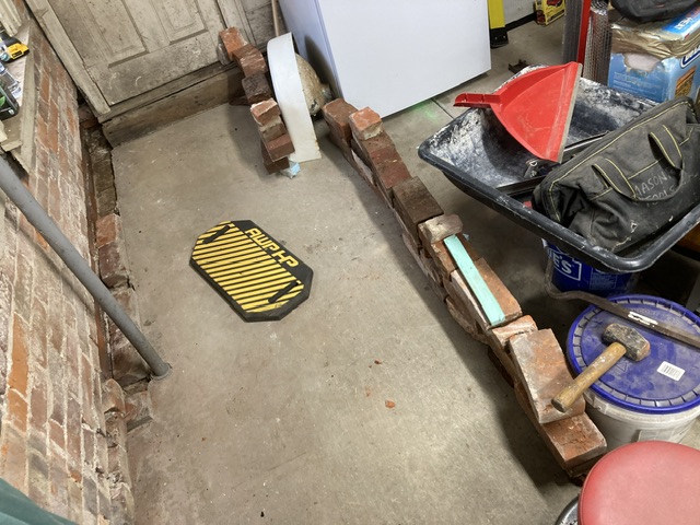

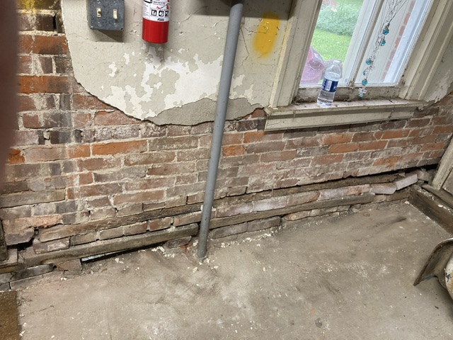

As I have posted before, the mid-1800's portion of the shop had some issues where the oak nailers for the base board was laid into the original brick. This is the last section to repair.

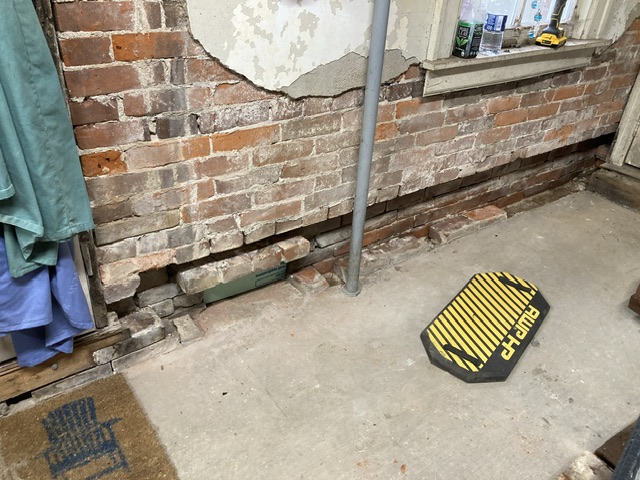

First I remove everything that is loose…
Then dry fit with all of the original bricks and all of the extras I have found and scrounged from around the shop, old steps, etc.

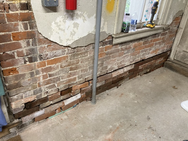

Next I pull them all back out and stack them top to bottom ready for mixing mortar and laying back in place tomorrow.
Hopefully my post tomorrow indicates it is done. This is the 3rd section so I have a process but never laid a brick before this adventure. Had some fun, learned a lot. Including a greater appreciation for the masons out there and the fact that I will never make a living being one. 😁

when stacking the bricks have a bucket of water next to you, dip every brick in the water for a while to absorb some water. then put mortar and do your thing. the moist bricks will not draw that much water from the cement mix. concrete cures and a long curing time produces a stronger cement. cheers

Thanks! Learned that on the first patch. A video had suggested spratlying them with a bottle. These old bricks were more thirsty that. Couldn't make them even slightly moist with a spray so got a dipping bucket for them. Worked great.
