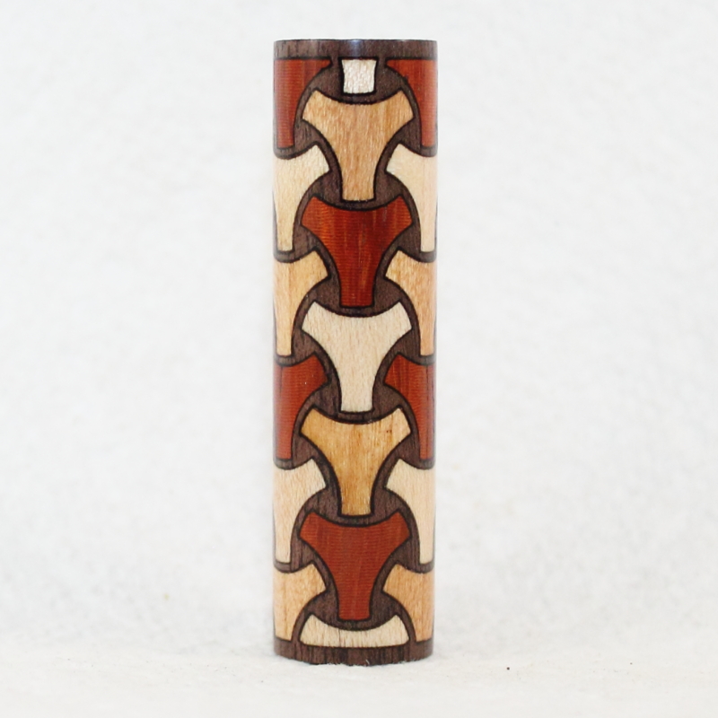

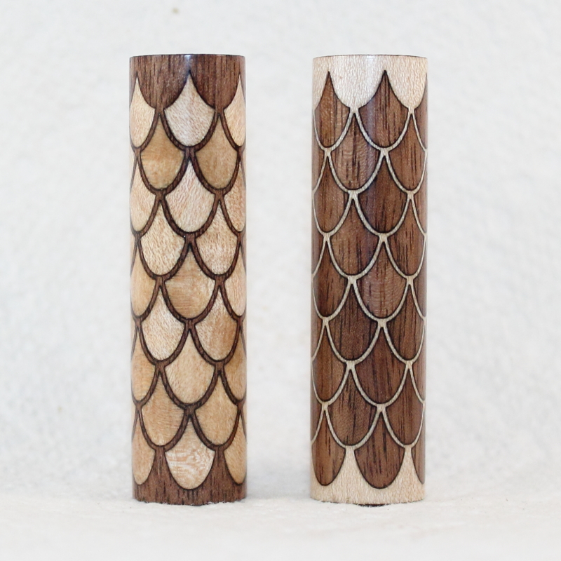

Here's a couple of patterns I did this week. The first photo is my take on a Sierra scales pattern the woods are walnut and maple and there are 54 inlays in each blank. The second photo is a tri-colored round Celtic weave. The woods are walnut, maple, cherry and padauk. There are 39 inlays in this blank.
