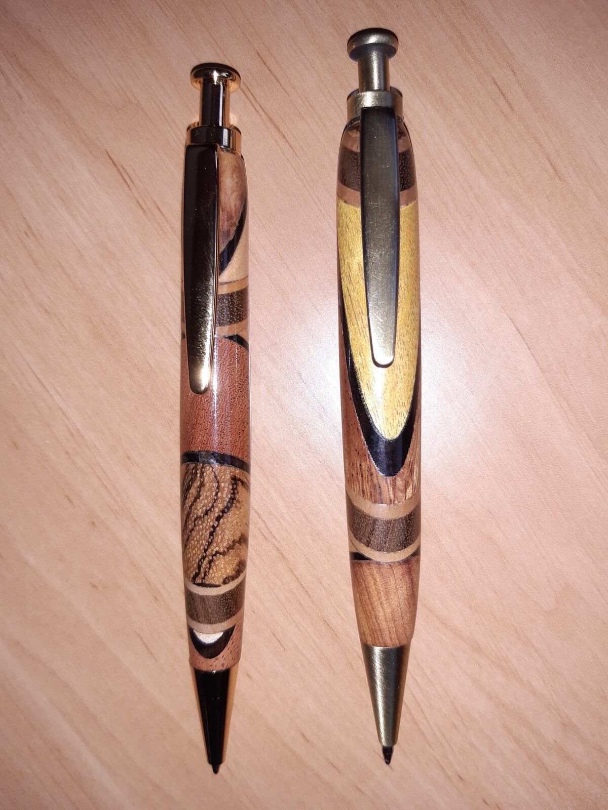

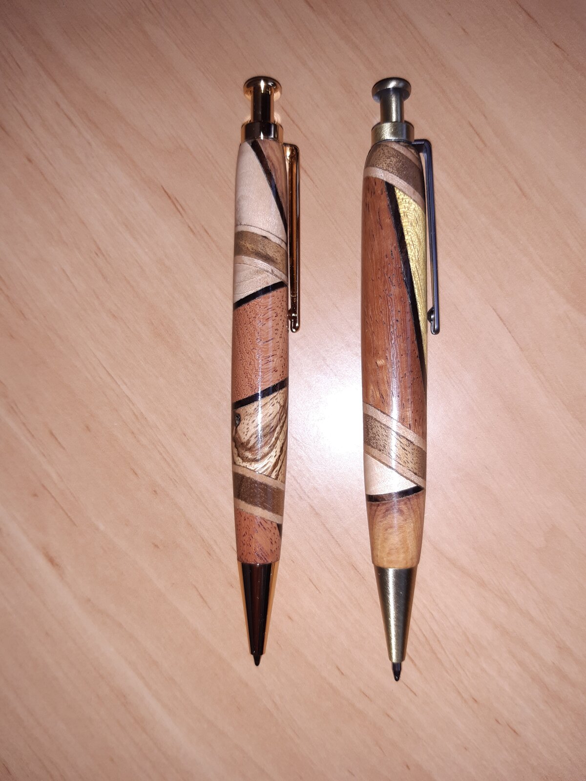

A new trick for me, having read Marks thread and excellent explanation I decided to have a go. I made the two pens today having spent two days making the blanks as per Mark's description.
I had one separate when drilling but managed to repair it with difficulty using CA.
I used Tightbond which I have always used with success but with such complicated lamination not convinced this is the best.
Anyway for my first attempt I am quite pleased.

Nice job of segmenting/laminating, Michael !!!
I really like this kind of "random" segmentation !!
Keep us posted as you do more, please !
Nice job. You cant get better than Titebond when it's wood to wood. I have had really good luck with Titebond translucent.
Very nice. I saw that recent thread on random segmenting and it interested me. Right now I have just glued up the first big slab as the first step in the process. We'll see how it goes.
A bit bored at work so I am squeezing this in as part of my professional development đź‘Ť
I have really liked the adhesion of Titebond Quick and Thick for segmenting/laminating small wood-to-wood glue ups like pen blanks. Works fast and dries clear.
My only comment with Tightbond when drilling take it slow it seems soften if you generate any heat but I think CA would have the same problem. Maybe Epoxy may work better, The problem seems greater at either end of the pen where you may have small pieces of wood. So when you cut your blanks try to leave more wood.
Please believe me this was my first attempt with Marks method and I am learning as I go along.
Thank you all for your comments and advice.
Heat affects all types of glue. There are lots of variables on the cause of excessive heat. Drill sharpness, drill speed, length of time drilling before extracting and cleaning off the bit. I cool my bits with DNA.
Thank you for your comments. You are right but having spent most of my life in engineering my drills are always sharp but yes backing of and cleaning is important so as not to generate excessive heat. I Drill on my lathe at slow speed and gentle feed rates. I may give it another go with Epoxy. Out of two pens only one failure .
