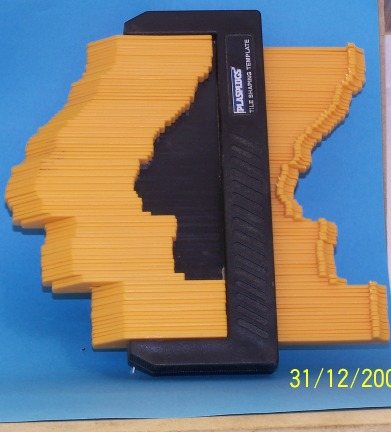

Hi Fred, I also laid tons of the stuff in my house.
My best tips are;
1. Knee Pads
2. Start from the most complex wall
3. Knee Pads
4. one of these,
<br />
5. Did I mention knee pads
and of course the one that everyone claims to do, but always ignores,
6. Measure twice, check which end you are going to cut twice,cut once
