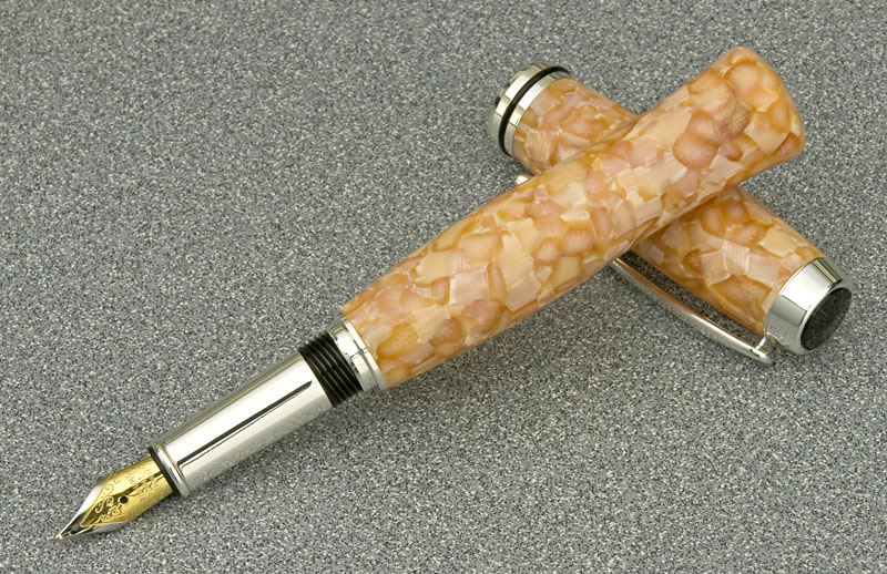

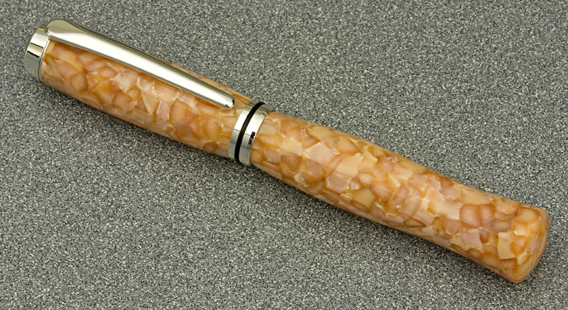

This is the most girly pen I have made to date, Peach Invisavue blank (I got it from Woodcraft, but others sell it as well...) on a Sterling Silver Navigator/Baron Fountain Pen, done as a closed end body.
This was my first closed end pen, and I had made a mistake with the depth of the blind hole I drilled, so the body is a good 1/2 in minimum shorter than "normal" so this particular pen is limited to the short cartridge ink, since the pumps or full size cartridges will not fit in the short body...

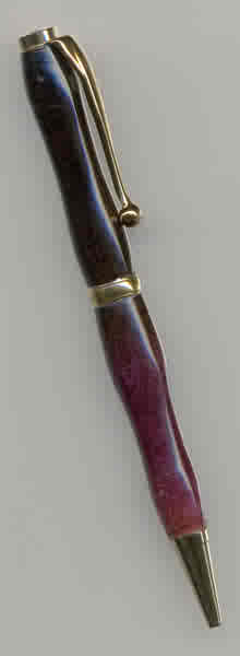

I made this one out of a Slimline with Purple Heart for the wife. Dad tried to speed up the color change in the microwave, hence the dark brown to purple transition. As an added note, I'm aware it's not a fountain pen, just showing where I went when I didn't want to do something super femmy but still needed to cater to the wife's tastes. It can be done.
