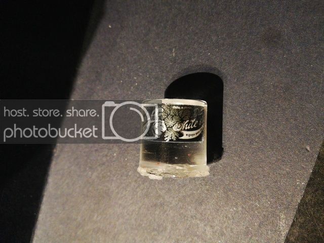

I've been trying to do some label pours with alumilite clear and have been hit by nothing but problems
I have tried modge podge (matt) and for a time all was perfect but then I started getting cloudy pours ...after demold mainly a few hours after demold ....I let the modge podge dry for 24hrs and it was a thin coat...and sometimes after cure you could see the modge podge ridges and a sort of metallic effect in spots
So I read about people using avery labels so I got some waterproof labels today printed using my laser printer and bang they where perfect....the about an hour after demold they have what I can only describe as a metallic effect to them and as time goes on its getting worse the entire picture has this metalic effect like the resin is either sucking the ink out or not sticking to it
Does anyone have any idea what is going wrong with either the modge podge or the printer versions as it's doing my head in now

Jas it will help if you post some photos of what you are talking about we may call it something different. Alumilite has a narrow open time so needs to get under pressure quickly. What pressure are you using and for how long before demolding. ?? Many people use CA and do not use mod poge. Not sure hoiw much help I will be because I do not use alumilite.
You can see the frost silver sort of effect on the black color that's the metallic type that I mean
When it comes out the pressure pot they are a perfect black and white image but after about 3 hrs that silver frost creeps into the whole design.
Pressure wise its at 60psi for and hour then out the pot I've tried 4 hours under 60 psi and it still did it
With the normal color mixes I do the resin is set fully after an hour but with these the overspill at the top of the mold is still soft and is still soft 8hrs later to the point I can bend and roll it up but same pour the color ones are solid....

I tried to blow that photo up but can not make it out at all. I would listen to the people who have done this and used that product. But for my suggestion leave the blank in the pot for at least 6 hours. Do not demold till next day. I and many other use a clear spray sealer and no mod podge. I use Testors sealer because I use Testors paper. Sorry but that is all I have.

I have tried not coating them as well mate and the results are the same, the pic is of an avery label that is uncoated
I get what your saying about it pulling away and think that's what it was doing on some mod podge ones but the label ones have all this frosted effect, it's almost like the resin is reacting with the ink as it only happens on the inked part never on the bare label.
The thing is when I do a color mix they come out and the resin is hard and crisp but with the label ones it is still so soft and looks like it is still curing as over time the pouring edge starts going milky white over time...and that's the time the labels start getting this appearence on them...
