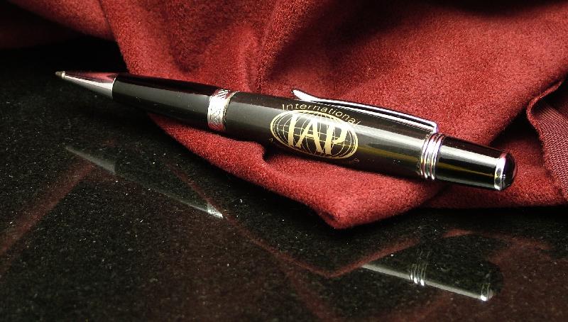

Still working on this .. got a few micro bubbles in the cast. Also didn't like
the ends .. seems like something got under the edge where the tubes end.
But this is closer than I've gotten before..

Are you casting under pressure? I had the same problems until I finally got my pot set up. It makes all the difference. You did a really nice job on this one though. I love the fact that you dug out the old printer. I use an "out of date" dot matrix printer to run 1-3/4" ribbon through for motivational awards for our church because new printers won't run things that skinny. There are still some things that "new and improved" can't best! Keep up the great work.

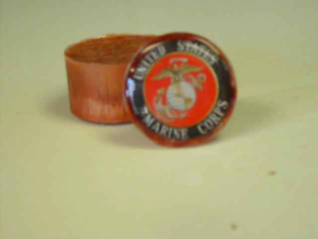

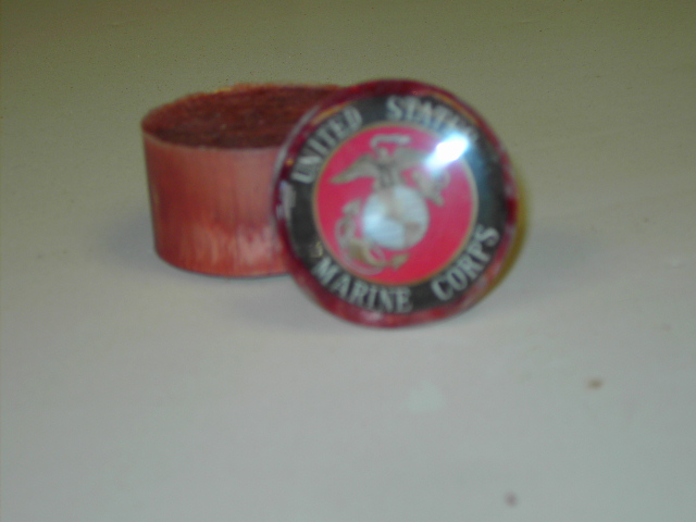

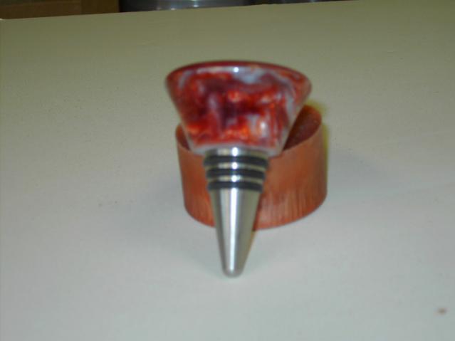

I just finished this bottle stopper. The emblem is from my brother inkjet printer. Before casting I sprayed on about 4 coats of lacquer. The ink didn't run but a few air bubbles.
sorry about the pictures I don't know why they came out crummy

Change your focus or you're to near of the bottle stopper step back a little
and repost the pictures
