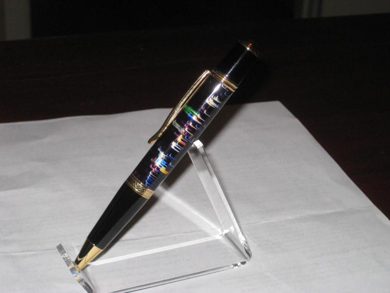

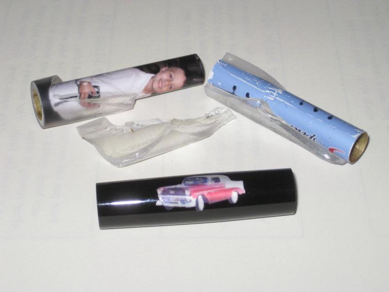

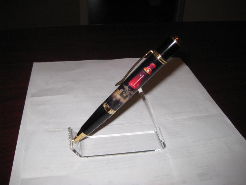

I've never tried a laser printer. I use an inkjet printer. I have done several photo pens. Some worked. Some didn't. I can tell you what worked for me.
I use some media called: Inkjet Photo Glossy Film by Papilio (I think it's www.papilio.com -- they are in Ft. Worth, I think.)
I'm sure they would have some paper for laser printers too. This media is a glossy photo paper, is very thin and has peel and stick backing. I use regular photos, then shrink them down using photo editing software. I try to fill up a whole 8.5 x 11 page before printing, as the paper is about $2/page with shipping.
At first I was spraying the photos with Krylon "Preserve It" - Digital Photo & Paper Protectant. It worked fine. Later I tried just waiting 24 hours for the ink to be good and dry, and I cast them without spraying on the coating. Those worked fine too.
I have used both PR and Alumilite. Alumilite is much friendlier to work with, but doesn't shine up quite as glossy as PR. All the attached photos are PR. One thing I discovered is that the PR doesn't want to bond to the photo itself. So, that requires very careful turning. Tools must be very sharp and work slowly. You can see in one photo where I blew up 2 out of 3 blanks.
As for the pens, I got the UT tower image by doing a google images search. The other photo is of the Dallas sky line at night. I took that photo.
I've found that black/dark backgrounds are best for hiding the seam. I overlap the seam.
I'm no expert at this, but find it fun and don't mind sharing things I've found that work and don't work.
Good luck!

In the "no bubbles casting" thread there is a tip on brushing the PR onto the tube and curing that before casting the whole thing. I bet that would solve your adhesion trouble...
