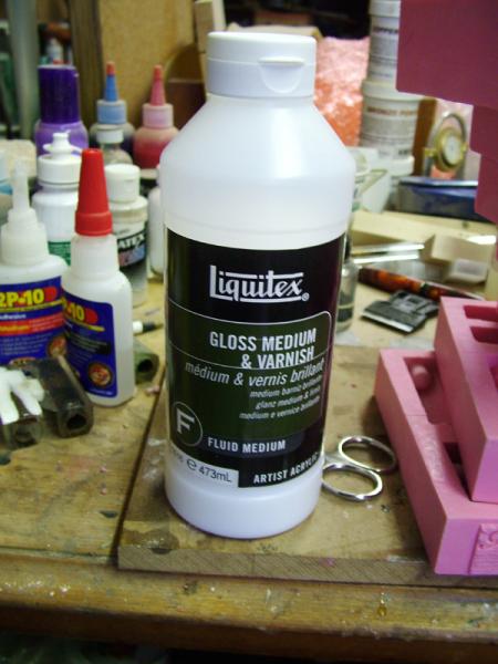

I've had pretty good luck sealing labels with spray lacquer. If sprayed very lightly, it dries super fast, so I have not had problems with inks running. I put two or three light coats on at least an hour apart and then let it sit for at least a day. YMMV
this stuff seals pretty well and dries clear. Make sure the ink is
thoroughly dry first.. maybe a day or so. Keeps the resin from
soaking the paper or releasing the adhesive.

I usually use gloss ModgePodge.... CA gives me fits! Others swear by it. Might get me some of Charlie's varnish, simply because I have SO much room in the shop.

The varnish is used by artists, so most any art supply store will have it.
If you live in a more populous area, some of the box stores MIGHT carry
it, but living in the sticks I find the box stores only carry flagship stuff. If they
can't turn it over in 30 days, they won't stock it at all.
