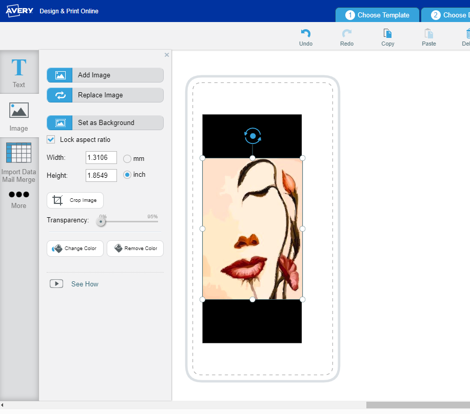

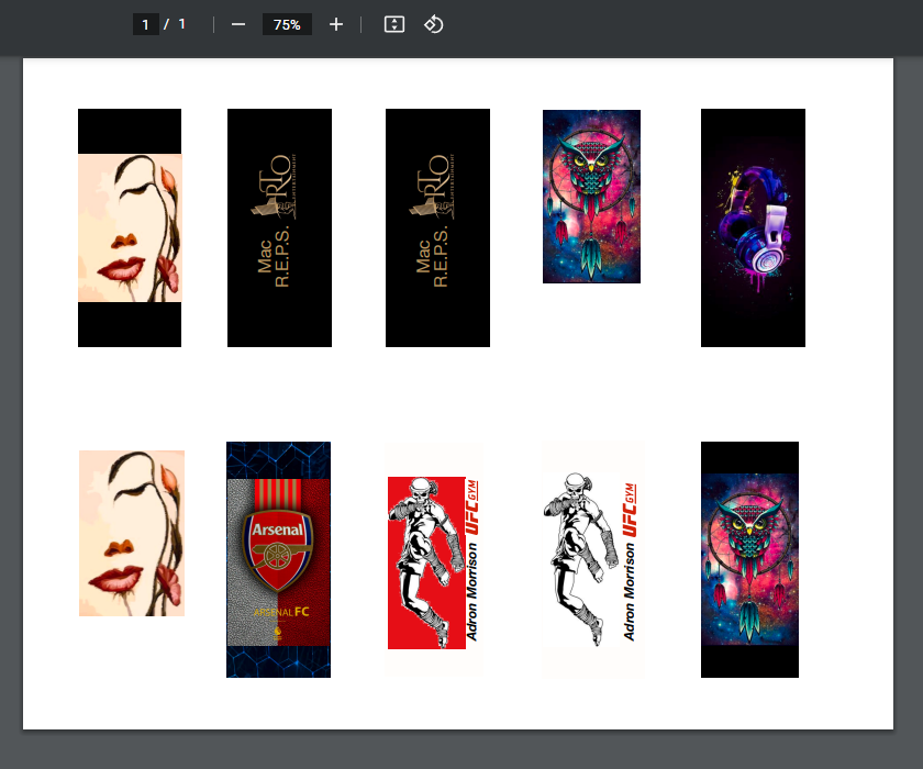

I just started label casting also. I use the Avery label software and set it for the 4x2 8163 labels. You can precisely control the size of the label to the .0001". It is also an easy editor for color changes and fonts etc. Very simple and does most of what Illustrator will do especially if you prep the image first. It then produces a PDF to print. You can also control which labels it prints so you can only print one or two and still feed the sheet through as many times as you want until it's full or like the way they look.
You can buy templates but I just used calipers and a band saw and made them myself from plexi.

View attachment 350891View attachment 350892
I get all of this I use avrey 18163 for the template but all the wasted space
Hmm...never thought of it as wasted space but yeah, you're right. Couldn't you just cut and paste them into Word or Illustrator etc...? Ten on a page spaces them out nicely for me so I'm ok with the spacing. Can't see how you'd have room for more than 2 or 3 more unless I'm not understanding you.
