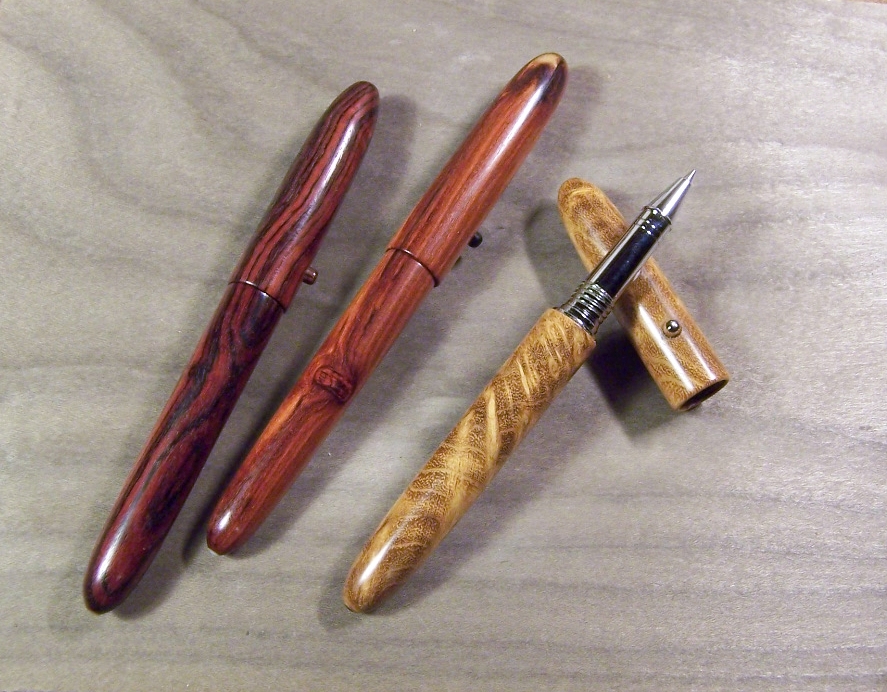

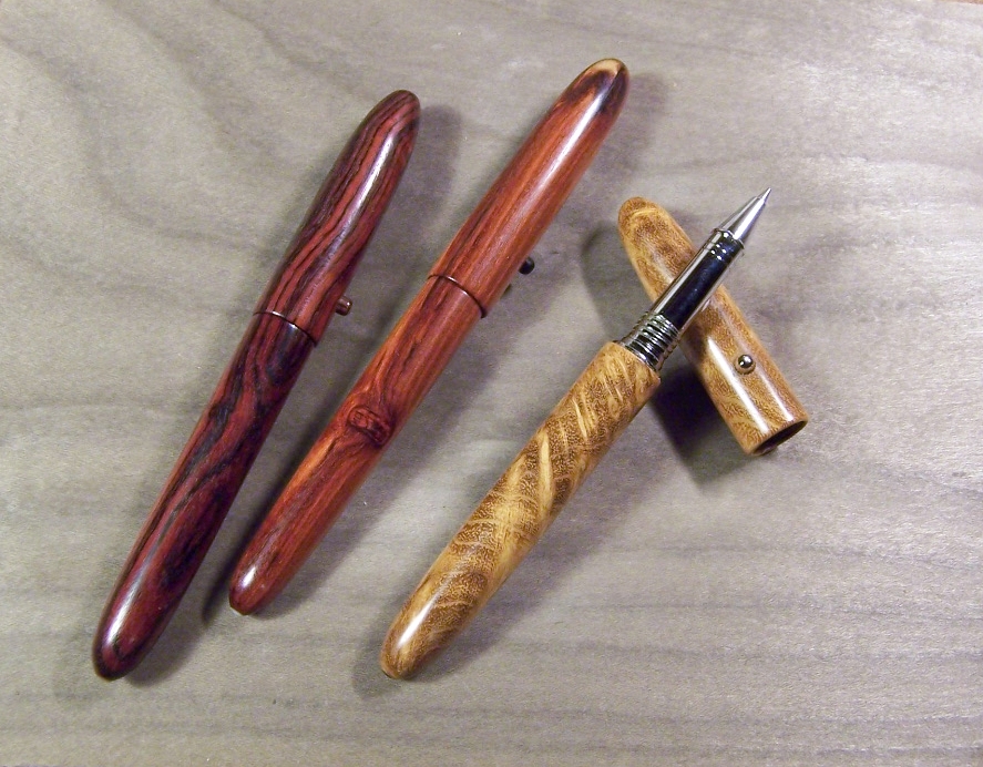

I made some closed end pens using various 10.5 - 12.5mm tubes, Atrax, Vial and others. Most of them have interchangeable nibs for RB or FP. I turned down the center band a bit so that I could hide it under the wood. Hope it helps.
Beautiful pens. I keep thinking about trying closed end but not sure about what kits to try and what tools I need. However, this thread has helped and got the juices flowing again. All I need now is a working lathe. The speed control electronics went poof over a month ago. I am hoping that the new "expensive" board arrives today.
