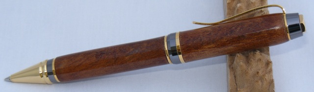

I use straight CA when finishing and the results look like this.
It's still much darker than the raw wood, but I like it.

Mike, yours looks very much like the one I did last night.
