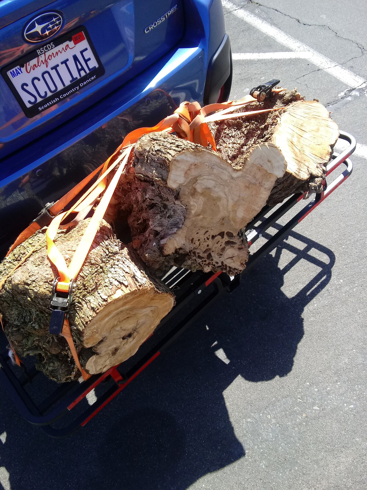

Just picked this olive up. Now....
Ray-CA
Nov 14, 2020
333
San Diego CA, USA (SAN)
...what's the best way to cut it up for drying?
Ray
Seal the ends with anchor seal, keep in dark even temp for at least year. That is what I do with my California Olive wood I get from Central Valley. Then I will cut into over sized blanks , let dry out more, then turn.
also Can take and rough turn for bowl, need to dry out for several mos.
nice stuff.
charlie
"...dark even temp...". Yeah, wife is going to like that. "But I have to keep the wood at an even temperature so it dries properly. That's why it's in the closet!"
Can I rough cut it to get more surface area for drying?
You can rough cut and it will help. Like turn bowls with thick walls That all helps. I have a good stash drying for fall turning.
