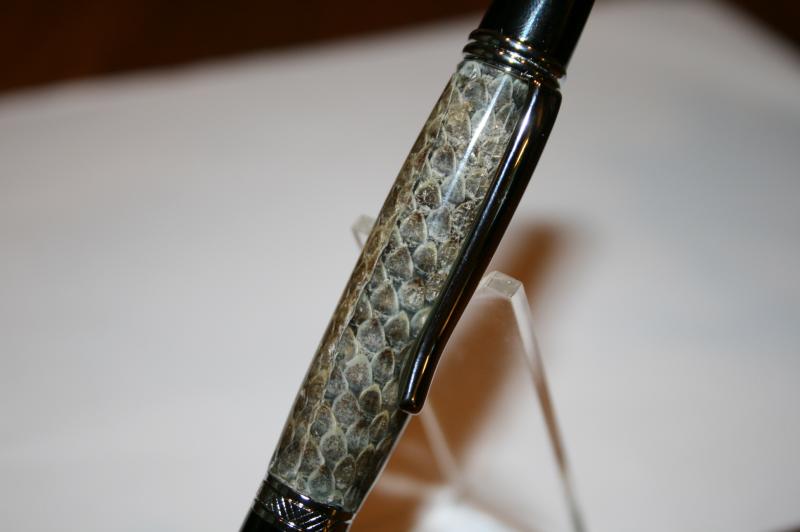

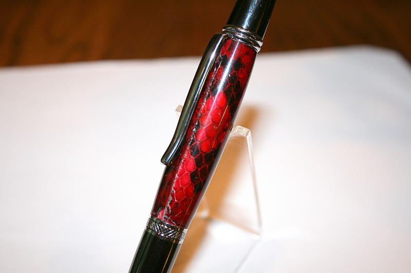

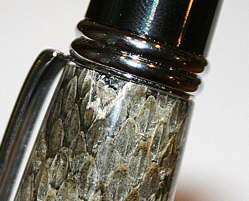

I recently bought some snakeskin blanks for a seller on the site. The first time I tried to turn them the tubes pushed out the other side of 2 of the blanks and the third had bare skin coming through before it was even turned to the right side. I just though it was a mishap and returned them for some replacements. I just thought that I would show some pictures of the fixed blanks. As you can tell the blanks were not turned to far that is why I included assembled pictures.
By the way, I will not post the name publicly if you want to know just pm. Sorry for the rant, this is the first negative post I have made. I just don't want anybody else to get "burned". Russell

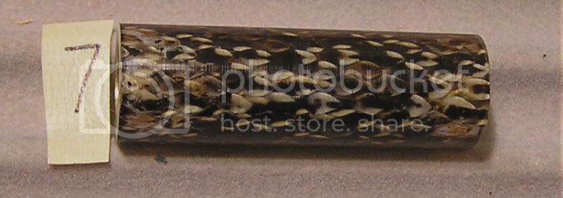

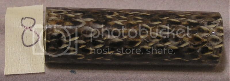

Snake skin is a PIA to cast. The seam looks real bad on that. I when I do snake skins have a special way of hiding the seam. It takes time but it can be hidden. The silvery look could be the skins were coated with CA this helps prevent air issues when not using pressure but there are other ways to avoid it. The silvery look is air that is trapped between the skin and resin one of the problem that takes experience to avoid. Turning through a skin well depending on the skin some are thick there not paper. Pythons are known to be very thick skin very hard to hide the seam and take a lot of room. I would not turn a python straight down to the part like you did. I would leave it a little proud and round it it. Also after squaring the ends and always sand don't use a mill it could catch & tear. You should seal the ends with CA remember you are exposing skin it is like a sponge it will let dust and any moisture in from sanding.
I think I addressed a lot of issues associated with snake skins.
Again I don't know who's they are and don't want to know but I do have a little experience with skins.
Thanks bruce 119 my point was that of the 6 blanks total that I got, ALL were defective. I just have no desire to do business with this person again. That being said I have had VERY good luck with all the other vendors that I have had dealings with. We just need to be careful with our HARD earned money.

Another thing that happens frequently on the ends. When the ends go milky this is usually caused by separation from the resin. What has happen is the resin has separated from the skin I have seen this often. The causes are the bushings too tight perhaps a catch and shocking the ends also when pressing in the parts if they are too tight or you skew off when pressing. It causes the brass tube to expand very bad with snake skin. If the brass tube expands you will more than likely get a separation and it will show as a milky looking on the ends that is not fixable. I would never make a snake skin with Alumilite it is very prone to flexing and separation. Also be sure to seal the ends with CA that will keep dust and water out from wet sanding but will not help with separation. Only good technique and awareness will protect against separation.

Bruce the blanks were bad before the kit was assembled. I simply put them on the pen to show that they were not overturned. I could build them back up with ca glue but then the kit would not have the proper fit. I guess it is "live and learn".

Russell, I am sorry that you had a bad experience with this other seller. I don't know if I can do anything about the red python, but send me a PM with how many were rattlers. I have a few on sierras that I can replace these with. Let's see if we can't get a pen or two out for you. :cool:
Russell I wasn't indicating that was your problem. Just pointing out some of the common things that can go wrong. Like I said before casting snake skin especially rattlers is a PIA and takes a little time to get it rite. Look at the vendors history how long have they been doing it. What kind of pictures did they show before you bought were they hiding something. I always show both sides and turn them round and clean them up so the buyer can just what they are getting. I have seen some new sellers with good prices but bad photos:rolleyes:

I don't keep too many secrets. It's a matter of detail a nice small sharp scissors. Cut the piece of skin just over size say 1/16 then when you cut the overlapping top piece zig-zag and follow the scales it blends rite in. A straight line is a dead give-a-way and don't look good. That goes for anything a straight line in nature just doesn't look rite always cut on an angle or zigzag the cut a good rule of thumb for anything.
Take a look below that is a photo of the seam. I challenge anyone to find it. The link is to an old sale. I don't have time to make any now and only do them from time to time because they are a pain. I will not take names or am I doing a sales pitch please don't ask just trying to help others.

Actually, Bruce has nailed the answer.
Making the skins as he does (which Dawn posted long ago, as well), takes time and effort. Then a properly prepped skin needs time for the adhesive to cure fully before being cast. When cast, the pressure is one of several variables that must be controlled.
This is why you don't see a lot of "extremely well done" snakeskins for sale. The people who cast them quickly and with some "issues" have lowered the price to the point where it is not worthwhile to spend the time to make them correctly.:confused::confused::confused:
Most turners can't tell the difference until they have the problems described above.:eek::eek::frown::frown:
