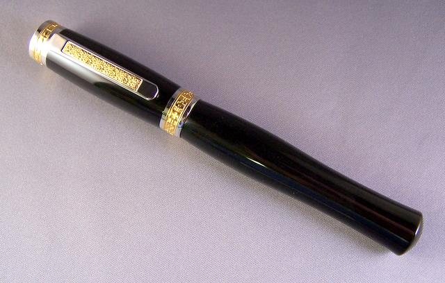

Now that I've seen Lance's pen, I'm sure black is the right choice.
