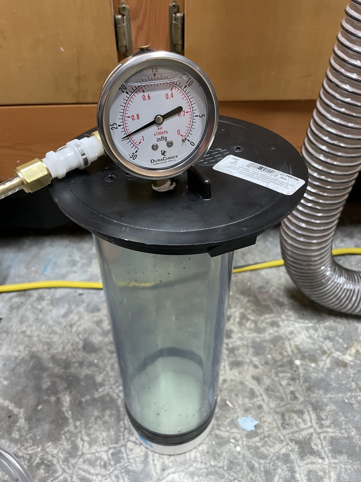

Update: My parts from TurnTex arrived. I put the chamber together along with a hasty lid (I'm surprised it sealed.). Put new oil in the pump and fired everything up. Not too shabby and the motor/pump seem to be humming along nicely.
Nice. Since your pump came to you fairly empty, I'd run it until everything gets warm and change the fluid completely. Just to flush it out.
buy the oil by the gallon.
That's a good call. I ran it for about an hour tonight. I'll probably warm it up tomorrow and change it out. It took almost a quart to fill it.
I don't know if it's normal or not but it's fairly noisy until it reaches full vacuum. Then it's really quiet.
Yes, thats normal.
