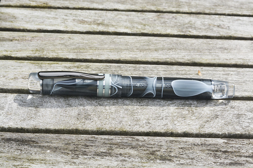

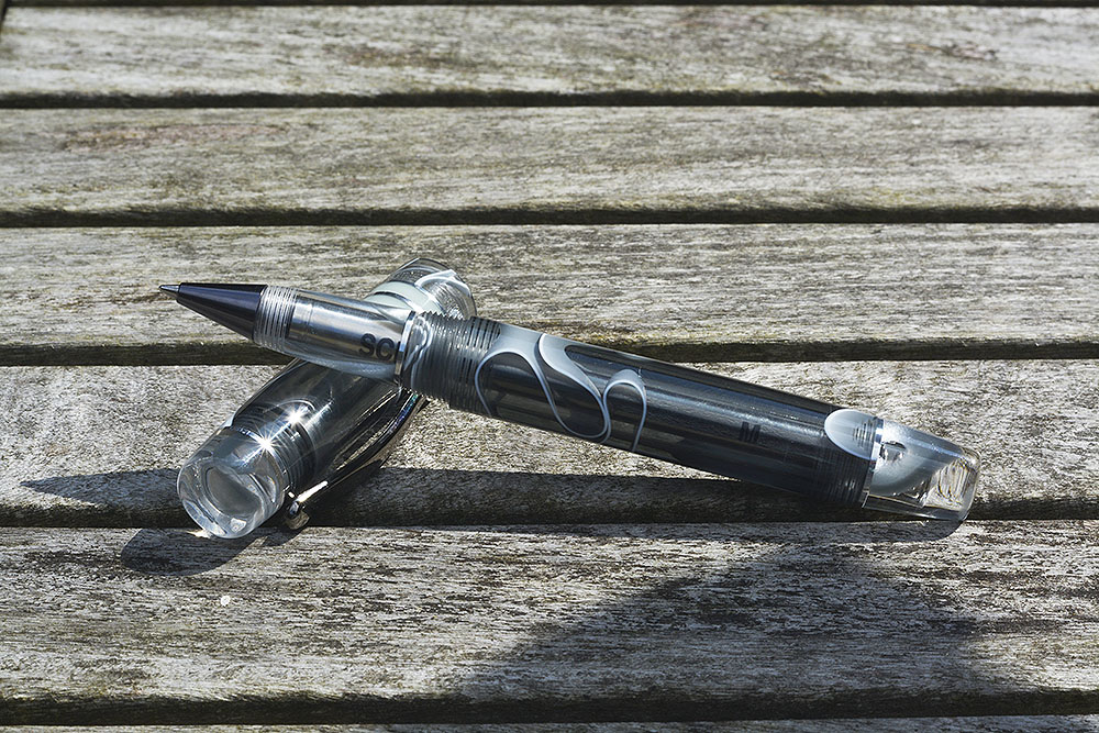

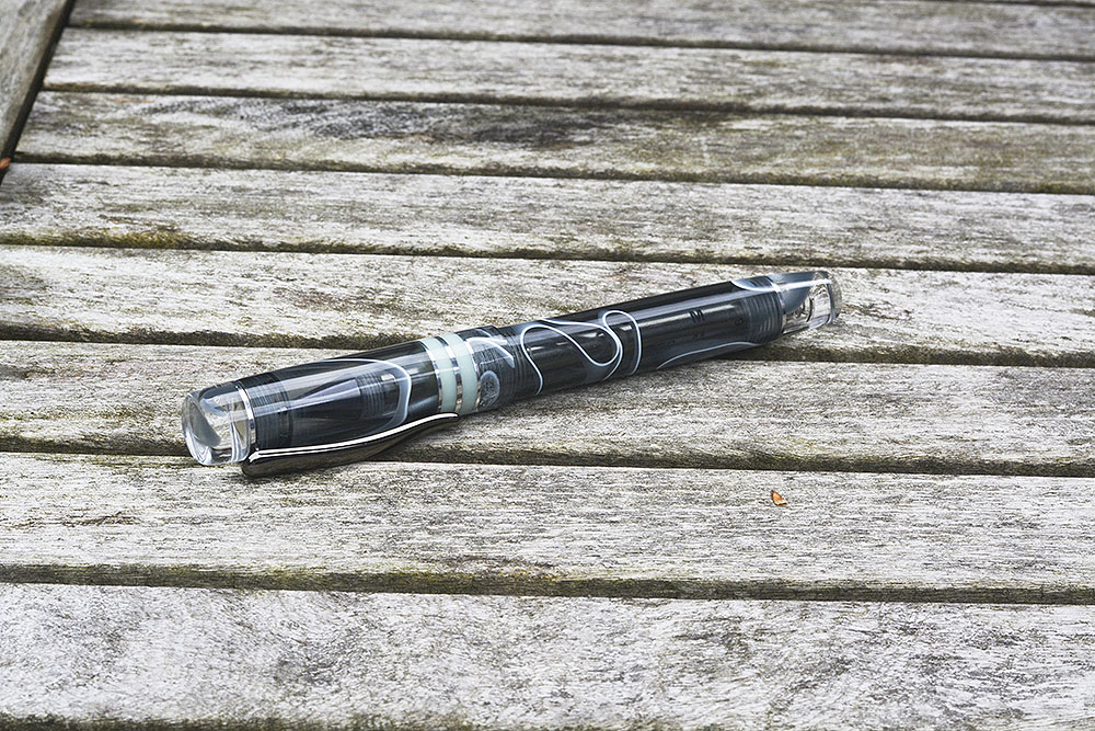

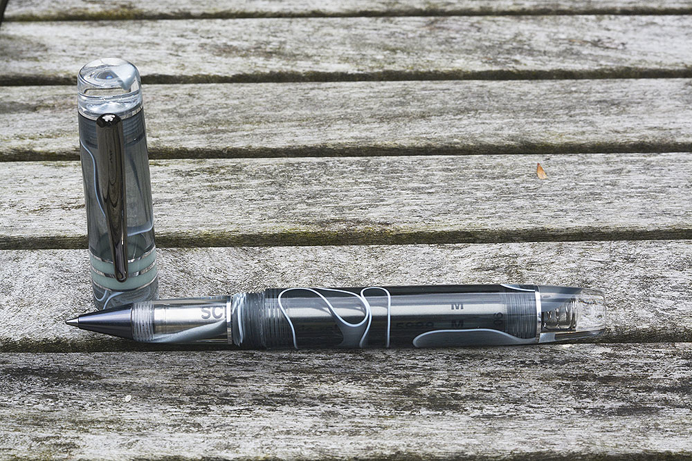

I haven't posted a pen in a while. This was a fun one and a little different, so I thought I would share it. Every part of this one needed to be sanded and polished, inside and out. That was the most difficult part here. It was a challenge, but I learned a lot making this one. I like how you can see the spring in the blind cap.
I used my Rick Herrell sliding tailstock collet holder on this one for the first time, and that is a great tool for using taps and dies. I also used a new mandrel from Rick...such good quality.
Grey Swirl Italian Acrylic - Vermont Freehand
Semplicita Nastro Silver Ribbon ends and section - Beaufort Ink
Semplicita sage cap bands - Beaufort Ink
Gunmetal plated Nib and Clip
Sterling Silver bands
Fits a Schmidt 5888 refill

Thank you! I have been working on using a method similar to the Edison Pen Company video, which shows in detail how they do internal polishing at minute 12:30. I use a homemade rod similar as shown in the video mounted on the lathe along with some mini holders from Amazon to get into the small pieces with a flexshaft. I wet sand internals to 400, first 2 Zonas, and then go through the Magic Juice steps to polish internals.

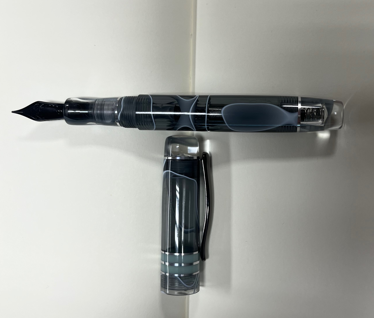

I kind of agree about the cartridge. I originally built it as a sort of demonstrator fountain pen, but I made a second section to hold the cartridge and thought it came out pretty nice. I was trying to figure out a body size that would accept a standard rollerball cartridge as well as a fountain pen converter, and be able to swap. The only thing you need to do to convert to a fountain is swap out the section and remove the spring from the blind cap, which I forgot to do for this quick picture.
Black Jowo #6
